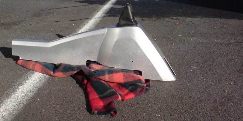

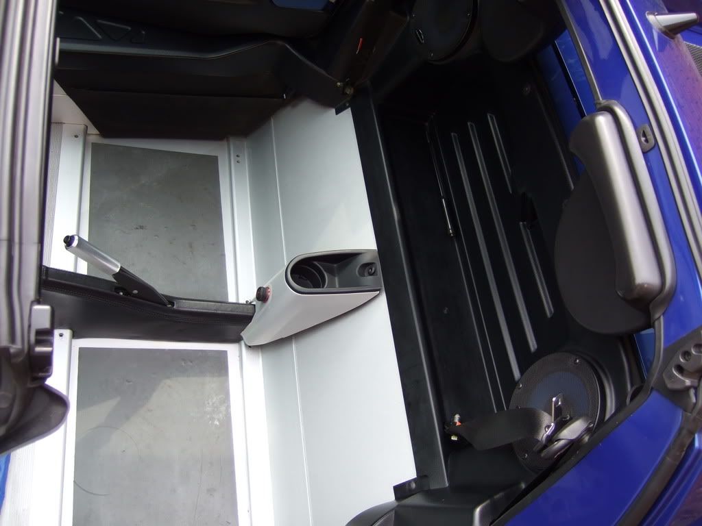

Right some of you longer standing members here might have seen me post in several of the "can you spray the interior" threads over the last year or so. Well I have been umming and arring for a while but I decided to strip out the interior and give my poor VX a really good interior clean. Unfortunely it didn't result in a bumper payday of lose change. Infact I was disappointed that all I found was a 2 pence piece and some pink feathers from a feather bower (don't ask!) :P
But nonetheless it was nice to get everything out and give it a good clean:
I always loved Moonland/gunmetal gray from days of 205 gti's gone by, so I thought I could have the next best thing, which is an interior that colour. Because it is a silvery gray sort of colour I think it fit's in with look nicely B)
Once I had everything out it was an easy decision to go for it as it really was looking pretty shabby to be honest. Couldn't really have looked worse. So anyway started stripping it all down and sanding ready for priming and spraying (in my spareroom :blink: not recommended!). If I am honest it really was a ball ache of a job, particularly the central gear shrowd thingy (and I ended up scratching it putting the seat back in gggrrr). But I am very pleased with the overall results and how it looks:
What do you all think? Be kind :P

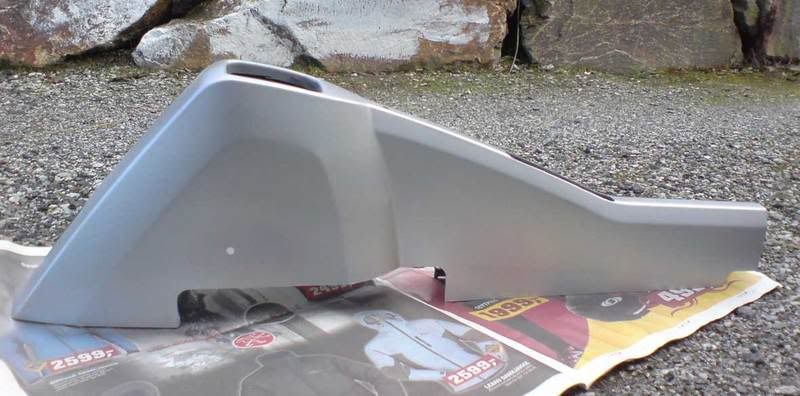

  • Location:West Berkshire
  • Interests:Motorsport, Computers, American football, Photography
Posted 23 April 2007 - 06:16 PM
Thanks for the positive replies guys. The good thing about it now is that I have done all the hard work, so if it ever needs a refresh again I can just sand back a little and add some extra coats on! :D
What paint did you use? Did you ever put any lacquer on it?

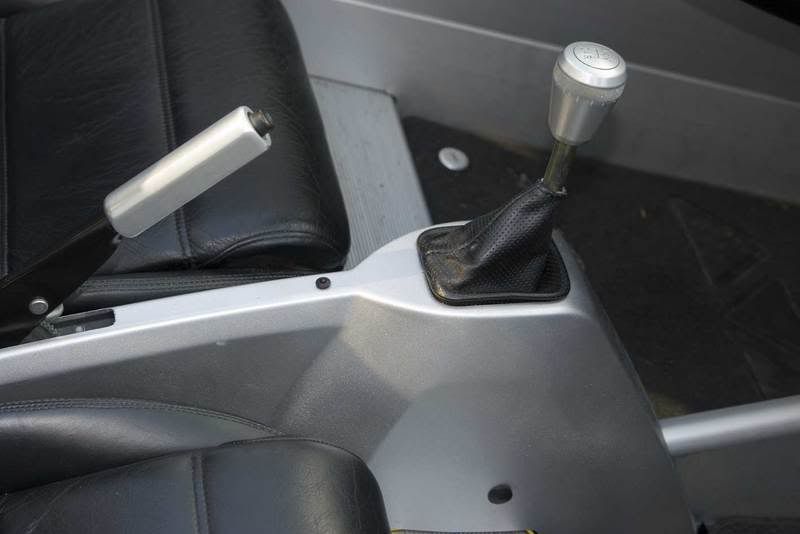

Hope that helps a little. See another angled pic below:
Apologies for my skany garage pillow! :P
