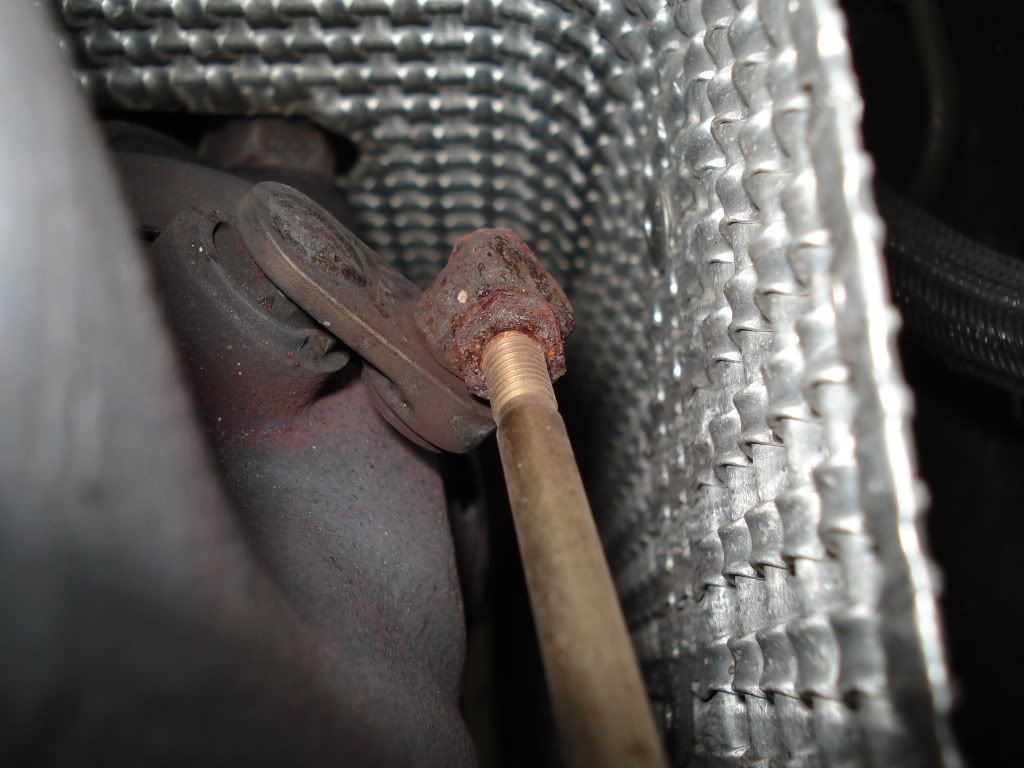

Hi just fitted a VXR turbo to mine. I did not get any probs with misfiring in fact it seemed to be running very well until it kicked in to limp mode when booted. With a some help from the kind members on here I adjusted the actuator as instructed and it does not overboost now. The thread on this is a little lower down in this forum. Rds Mick

Wind the actuator rod nuts down a little but as Micknw said I did'nt have any misfire just got kicked into limp mode when it boosted!

Sorry to thread hijack but I'm having overboost issues too and would like advice on how best to adjust the actuator.
Assuming the far bolt is the lock nut (?) what direction would you turn the near nut to reduce boost?

To reduce the boost you want to loosen the nuts, ie towards the end of the actuator shaft.

I just backed the two nuts off a few threads at a time and road tested until the car stopped overboosting. Not really much of a problem on a new actuator apart from the extreme heat from the manifold. It might be more tricky on a rusty actuator rod. Maybe it's an idea to run the outer nut up and down the thread a bit while cold before adjusting when hot.
