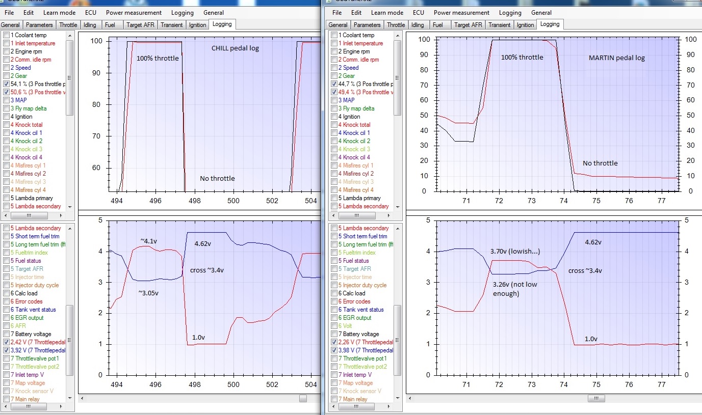

Comparison between Chill and Martin's pedal voltages.
Pedal has 2 potmeters that should give exact mirrored voltages to detect any wiring fault. Both extremes (0% and 100% throttle are the same (but his 100% signal is weaker at 3.7v), as are the crossover points around 3.4v.
It really looks like something is mechanically loose/wrong with the pedal actuation...
