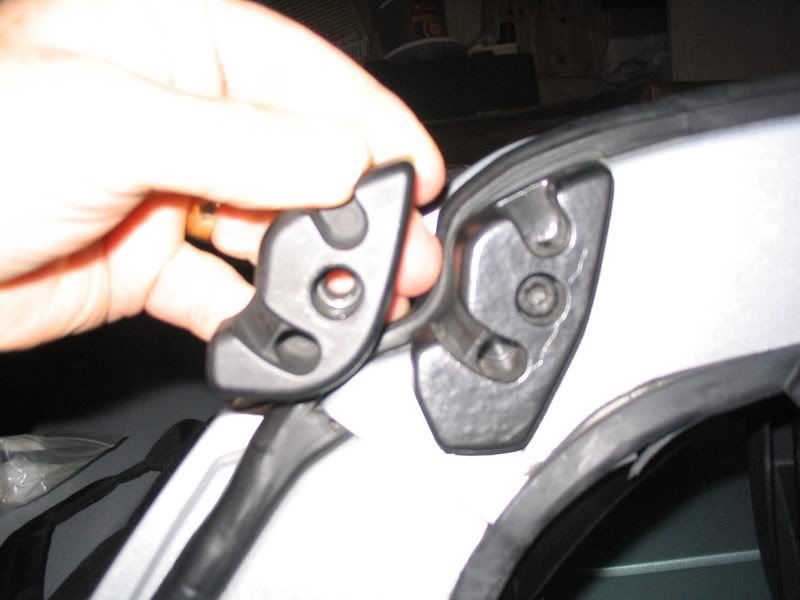

Here you go!
My VX dealer supplied new brackets with my VX hardtop. Photo below shows RH new one fitted and old one in my hand for comparison.
The part nos. appear to be
Right - 9197327 CANTR
and Left - 9197328 CANTR
The difference is the larger lug at the bottom of the bracket for the clamp to fit under.
This was 2001 so don't know whether they are still available.
