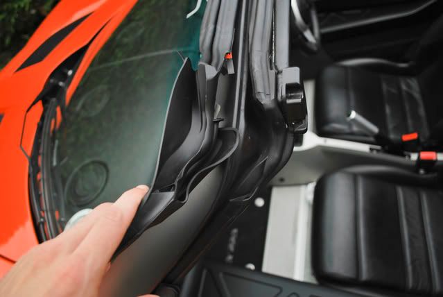

The new seal is at least twice as wide and sits at both the front and back edges across the screen-

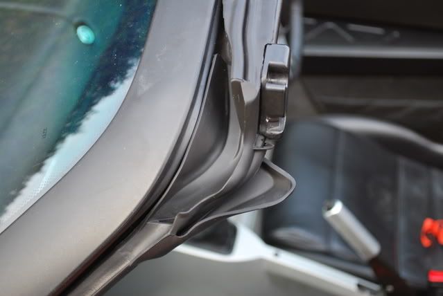

I'd expected the 'cup' as I've seen on the turbo seal, but this seal uses a 'cup' on the other side as well, creating a complete seal against the front of the windscreen frame. Comparison pic-

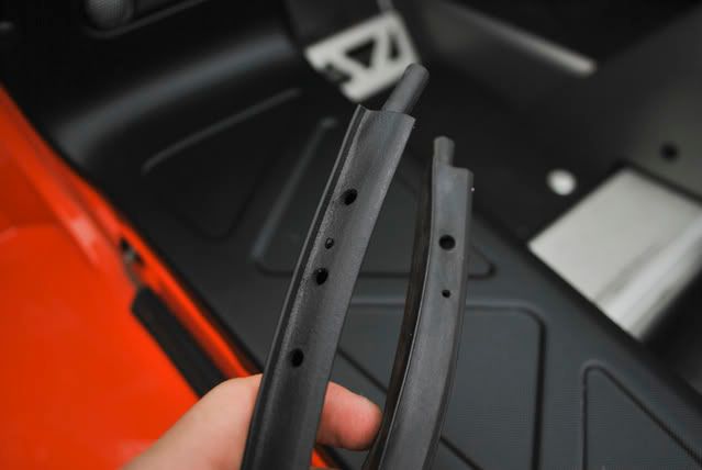

It has very different drainage channels, and uses extra drain / breath points throughout-

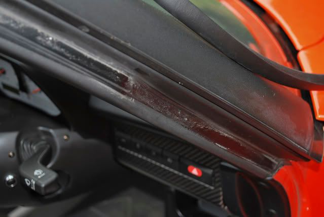

There were areas where it was obvious the seal had been unstuck for a very long time (maybe even never :rolleyes: )-

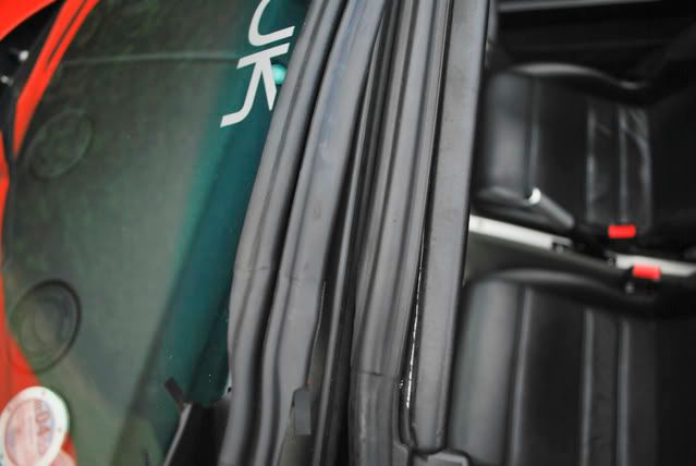

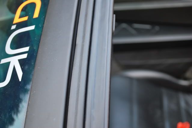

And the new seal fitted in place-
It poured down today - and not a single drop in the car thumbsup
