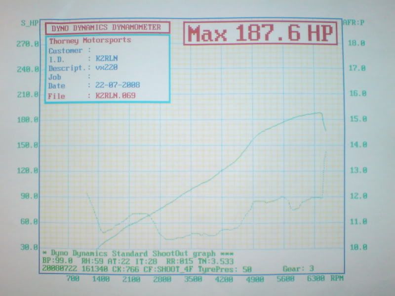

That's what it finally made after the epic mapping adventure it went through at TMS. In hindsight I probably wouldn't have bothered with the 2.4 intake manifold and sc injectors and left it at the stage 3 it was at before tinkering. It definately feels more powerful but I'm not sure the mid range pull is quite what it could be. I have a weapon R manifold waiting to be chopped up and from what I've heard it seems that putting it on along with a couple of other tweaks might aid the rich mid range fuelling. Will it ever end :rolleyes:

no offence mate, but those graphs are AFTER the remap?? did you actually pay for it after seein that fuelling?? :o
:groupjump:
There a month of mapping there you know ! :tumble:
:groupjump:
:o
how? why?!

Actually I think you will find it's five weeks :tumble: :tumble:

what happened in 5 weeks of mapping? :rolleyes: as they certainly didnt work on sorting any fueling!!

If that AFR plot is correct, from a correctly setup sensor rig, I would agreed with Guy's comments. Your mid range is dumping fuel into the chambers and your down on power. The mid range AFR mapping on the standard NA ECU ain't great by default, (programmed by monkeys in the Antarctic) and any mods outside of cylinder head work tend to amplify it.
Are you running with the vacuum hose connected to the fuel regulator?

to be honest the standard fuelling doesn't look much better :rolleyes: the main thing is does it drive better :unsure: in hindsight I should have fitted a standalone ecu instead of trying to get the z22se ecu mapped :o the difference between the standard ecu and a standalone ecu is night and day Imnotworthy not wanting to sound like a salesrep :dry: but the webcon itb's are worth every penny :wub:

I'll second that. thumbsup Certainly in your car, at least. The ITB's perfectly suit the mods you have and the customised map on the Webcon Alpha felt like it was perfect throughout the range, from where I was sitting.
Just wish the "fly by wire" Motec wasn't sooo expensive other wise I'd have signed the order by now. :(
