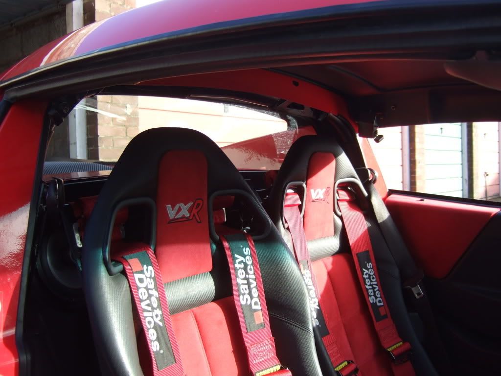

#5 smiley
Posted 23 March 2011 - 07:41 PM
Trim rubber:
#6 JimmyJamJerusalem
JimmyJamJerusalem
  • 10,382 posts
Posted 23 March 2011 - 08:28 PM
Still a ton of weight in the cover though!!
last one just coz I love it. Miss that ole car, she was stunning!

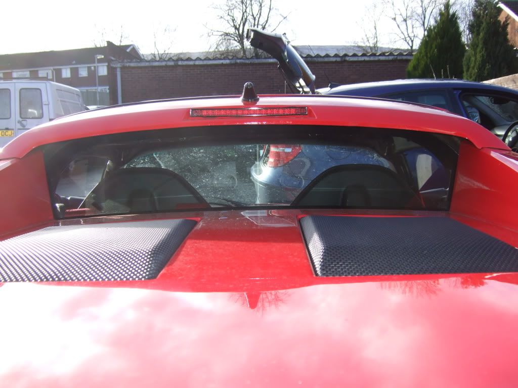

#14 Paulus H
Paulus H
  • 2,063 posts
  • Location:DE65 5NX
Posted 23 March 2011 - 11:05 PM
Allows you to move the seat back a "little".........
Paul
#15 Paulus H
Paulus H
  • 2,063 posts
  • Location:DE65 5NX
Posted 23 March 2011 - 11:07 PM
And yes the seat is as far back as it looks.... Paul
