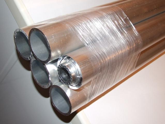

#1250 smiley
Posted 28 September 2013 - 05:26 PM
Laminovas are very very good
You want to fab a new bigger intake with longer and or more laminovas :)
There's a german guy taking that route atm.
Cutting out the oil filter housing in his brand new B207 that's in the way of the new design:
Some double length cores:
And the new pipes to put them in:
Let's see what frankenstein inlet comes out of that design :tt:
Edited by smiley, 28 September 2013 - 05:26 PM.
