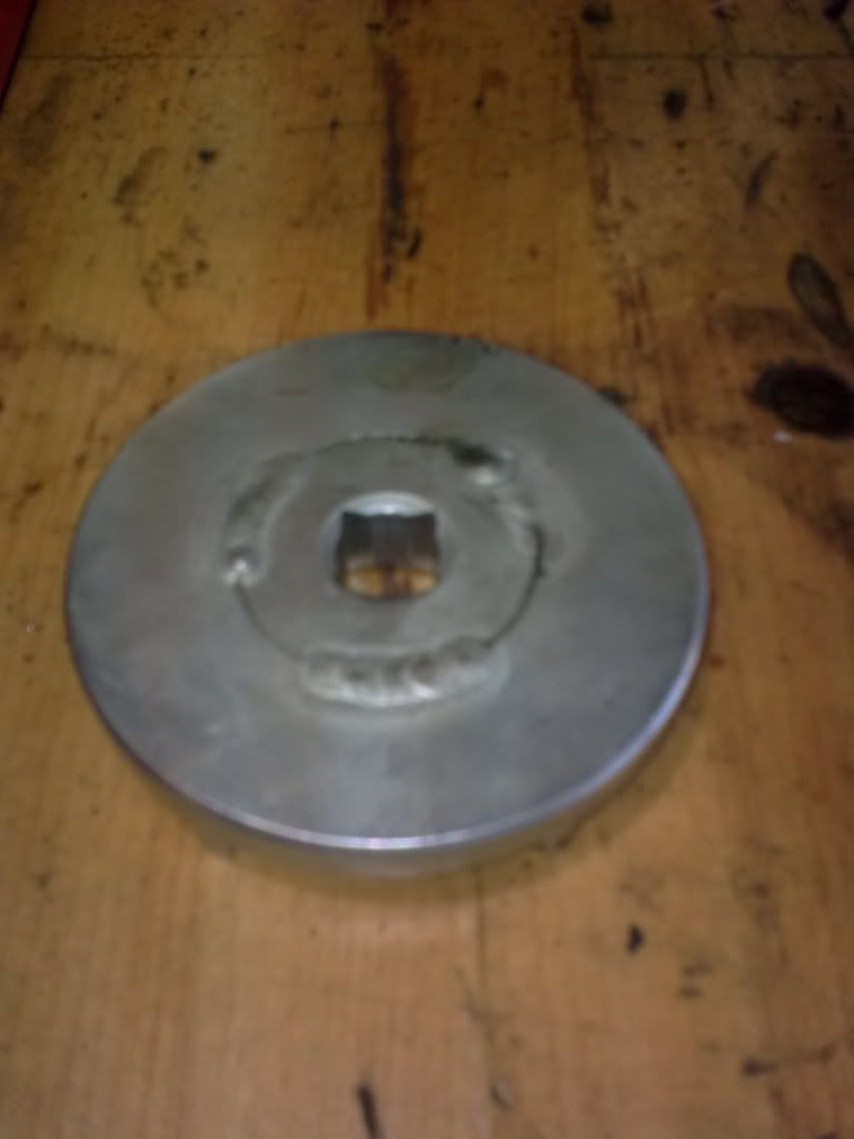

There is a special vauxhall tool to tighten the oil cooler adapter up ive just had to dig it out in work to tighten mine when it came loose while changing the filter. its a circular plate with lugs that locate in the adapter slots and 3/8 drive hole in centre. happy to lend it to anyone overnight local in need.

#17 greasemonkey
greasemonkey
  • 485 posts
  • Location:Stockport
  • Interests:trackdays, golf, fishing, skiing, cycling and 10k runs
Posted 11 May 2011 - 06:46 PM
Pic of the tool

Shame the only supplier i found want to charge £400 for that (LINK)
Wasn't someone looking into getting something made up for less than that?
