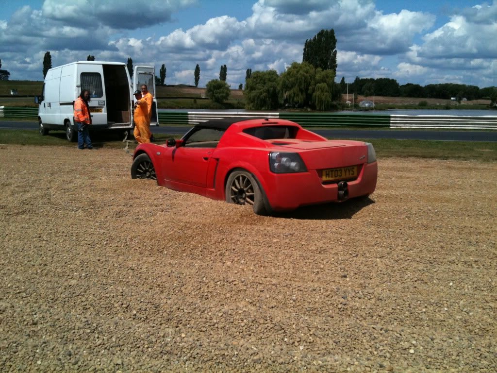

YOU CAN SEE THE ROUTE IN.....EVEN SOME OPPOSITE LOCK COULDN'T SAVE THIS ONE.

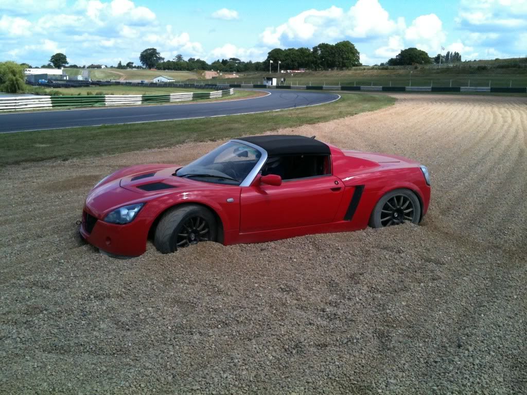

PRETTY DEEP, RESTING ON HER UNDERTRAY.
HEY, LOOK AT THAT FUNNY LITTLE PLASTIC CAR STUCK IN THE KITTY LITTER.

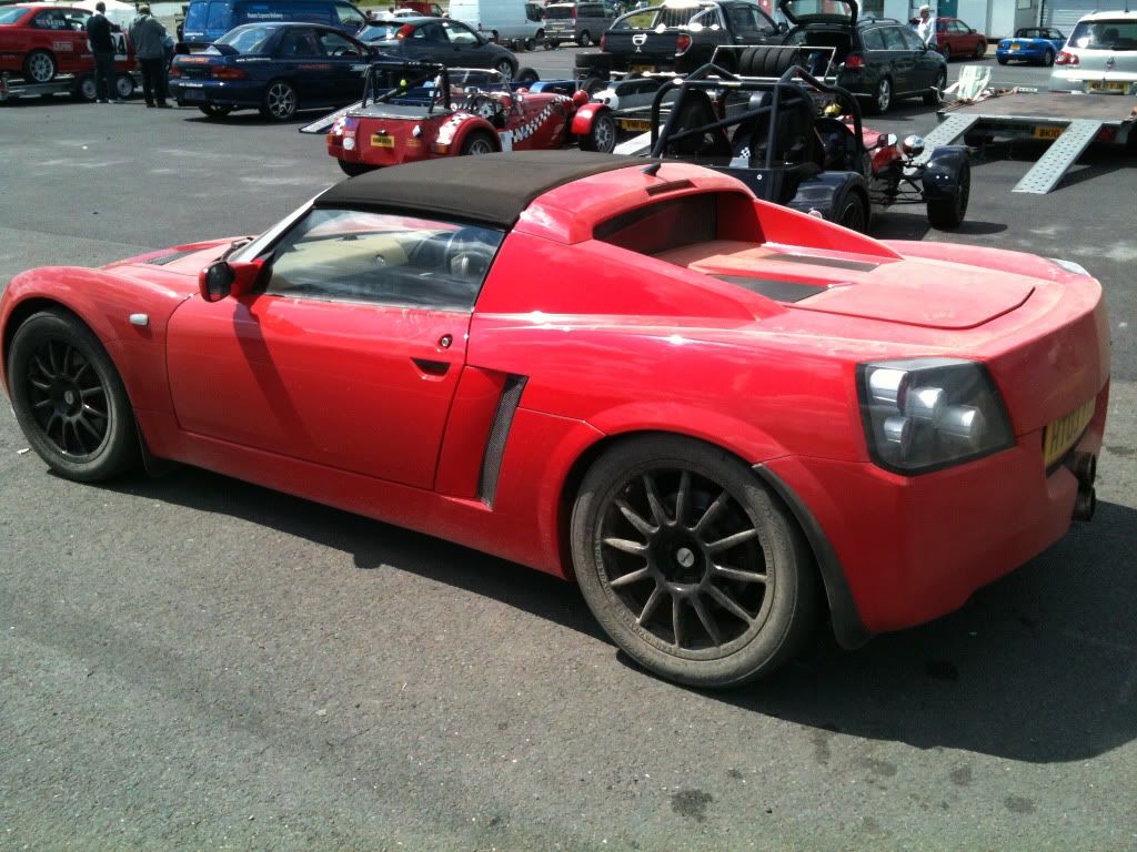

BACK IN THE PADDOCK LOOKING A BIT DUSTY.

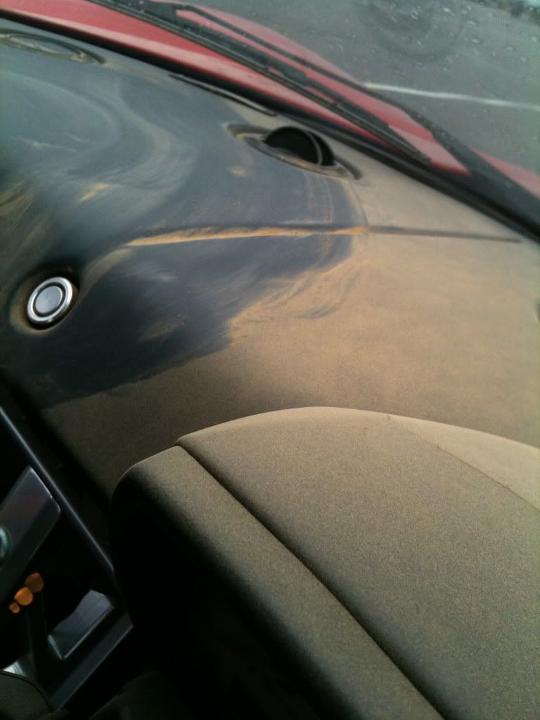

AND YOU THOUGHT YOU HAD A DUSTY DASH!

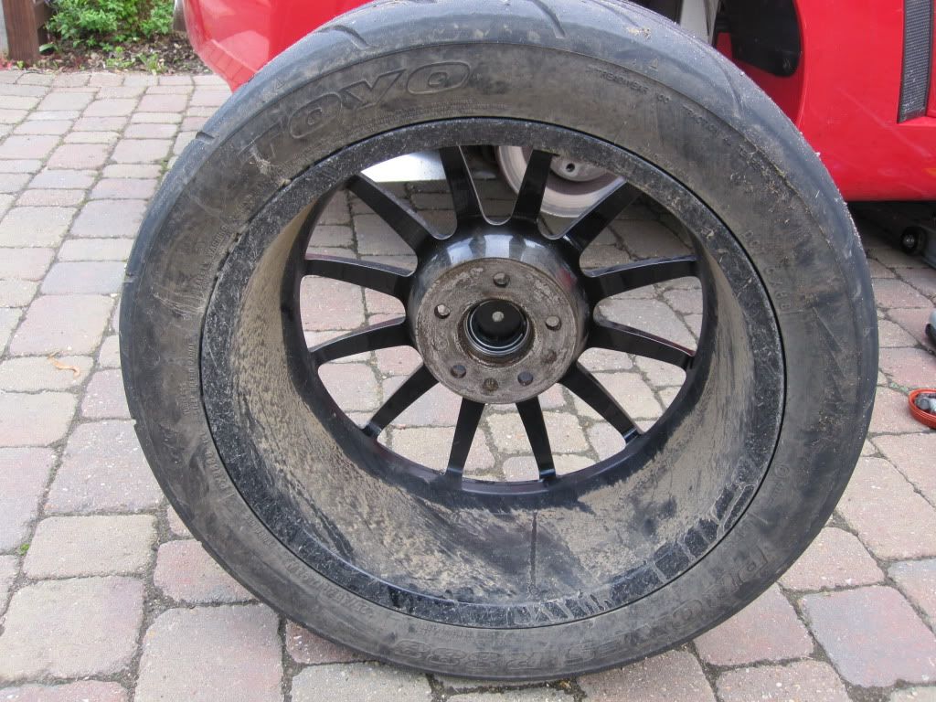

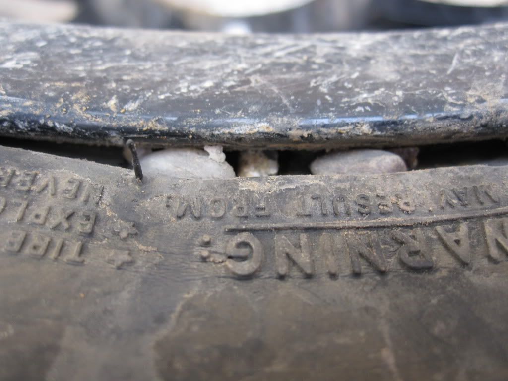

1. The rear drivers wheel has quite a few stones embedded between the tyre and the wheel rim (This was brand new only 2 months ago!)

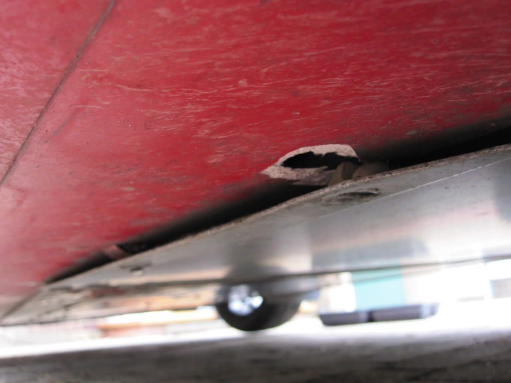

2. The middle under tray has been pulled from the retaining bracket with damage to the 3 fastenings
