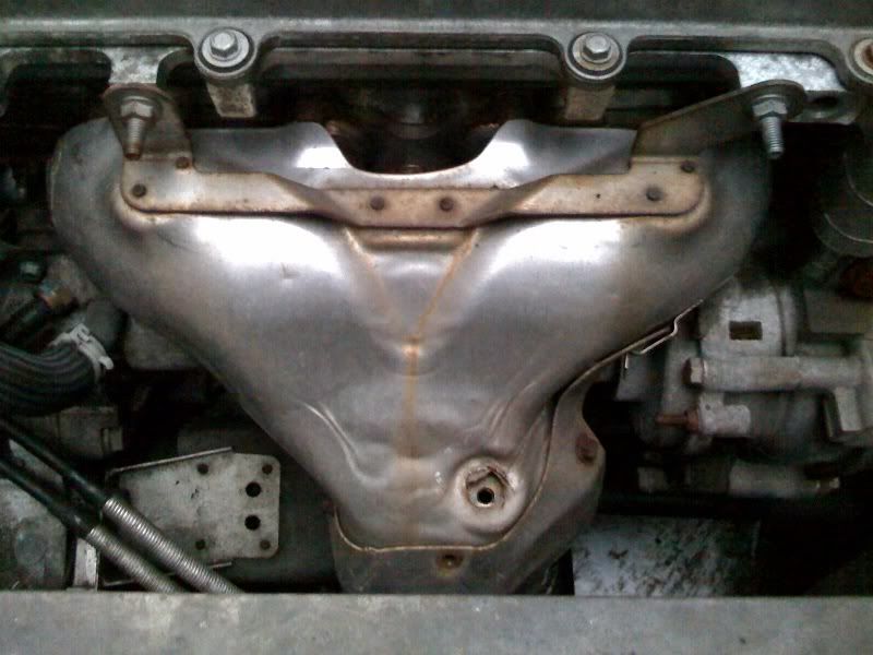

Attempted to remove the heat shield from the manifold, but looks like i need to remove the clam as i cant undo the 3 x 10mm bolts attached to the color of the heat shield (see pic from joes below), so i moved it to one side and put my fingers around it before it got hot to feel for any leaks. If it is cracked where do they normally go as i was unable feel any leaks.
You can remove and replace the manifold and heatshield with the clam on. Halfords flex head ratchet spanners fit, you however have to stretch and flex yourself and maybe sprawl over the clam. The bolts are going to be TIGHT!
The crack/split usually appears between the 2nd and 3rd primaries as the 1/2 and 3/4 pairs are cast together.
If you remove the top 2 bolts holding the heatshield on you can try bending it towards the boot then have a nosey at the manifold. *Possibly* enough room to get a look. I would bet on the tester not blocking the 1 pipe when taking the reading though.

I tried to remove the heat shield (even took the color off) and still unable to get it out. I did however manage to move it enough to inspect the manifold using my telescopic mirror and a good light, but unable to see any cracks or signs of exhaust gasses leaking. I also checked the cat and exhaust and did not feel any leaks. I decided to put the original exhaust on and change the Post Lambda sensor with a genuine vauxhall one (p/n 9201421)the sensor looked a lot different to the old one which i suspect is a cheap aftermarket one. i left the car to get up to temperature and went for a spin. i then went out again after 40 mins, pulled away and was greeted with p0141 so i cleared it and it has not come back. i assume the ECU was learning and noticed a difference compared to the old one?
