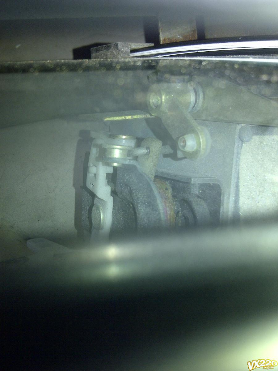

Posted ImagePosted ImagePosted Image VXT'ED
Since I'd put in the CMS poly inserts and with the SCing with balancer shaft delete I was getting all sorts buzzing and rattles, especially at idle.
Just finished doing this and it works a treat, you don't realise how rattly the windows are until it's gone.
No rattles even with the windows halfway or fully down.
I found I was able to do this with by only taking off the rear pad on the door and pulling back the seals a bit.
Trick was after undoing the two screws on the adjuster at the bottom, turn the adjuster screw so the block that the two screws tighten into is is in parallel with window guide.
Then you should be able to pull it up through the gap at the top of the door with a bit of twisting and turning.
If it still won't come out because the the adjusting screw is making the bottom too wide then you will need to turn it "anticlockwise" which will tighten it back in and you should be to pull it through. (Don't do it clockwise/tighten, it'll undo itself and fall into the bottom of the door :) )
For putting it back together the difficult part is getting the window guide into the two plastic lugs at the bottom of the glass.
I found if you have the windows all the way down, slot, wiggle, swear the guide down just below the metal support about halfway down the door (see pics).
Wind the window up, but keep the guide where it is and slot it through the first block, then keeping the block where it is wind the window up until the second block comes up and slot it in as well. Then while still holding the guide firm, wind the window until it's about an inch higher then top of the guide.
Now wind the window down, but this time move the guide with it until the hole at the top of the guide lines up with the hole in the door you need to put the screw in. (you may need to wedge the guide at a bit of an angle to make sure the guide stays in the block)
Hold the top of the guide and wind the window down past the top of the guide so you can get the top screw in and fix it in place.
Important: Put something below the hole to catch the screw if you drop it, if you don't you'll need to pull the door apart to get to it! (see pic)
Now look at the adjuster at the bottom and it should be just about in place, with a small screwdriver should be able to work it in the right hole and screw it in place.
I know it's all a bit long winded and probably doesn't make a lot of sense but when you're actually doing it you'll see what I mean.
Some pics below
