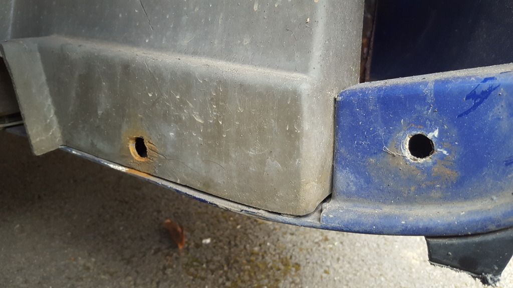

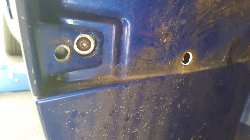

Can anyone suggest the best way to repair what's left (big holes!) once you get the old scrivets out?
I've got a nice shiny set of bolts (http://www.ebay.co.u...=item1e76dcec96) ready to go in but can't work out how best to build up the necessary support to install the new captive nuts. Has anyone successfully done this using a glass fibre repair kit? Any tips?

M5 jack nuts installed with the correct tool thumbsup

I used M5 wellnuts smothered with copious amounts of coppaslip. Works very well in the enlarged holes left after you remove the rust and crumbling fiberglass from the original fixings. Full kits are available from Speedy Fasteners on eBay or if you already have stainless bolts just buy the nuts separately. Cheers,Jon.

Sorry just noticed you've already bought them. Why do you want to build up the holes? They are designed to expand when you tighten the bolts.

For want of sounding more stupid do you glue them to the wheel liner? I almost lost one in a hole last night. Fnarr fnarr.

If you assemble them first it makes life easier and you won't lose the wellnut inside the sill. So, Bolt, washer, arch liner then wellnut tighten up finger tight then stick it into the hole and pinch up but not too tight until it won't pull out. Do coppaslip them though won't you. Dissimilar metals and all that.
