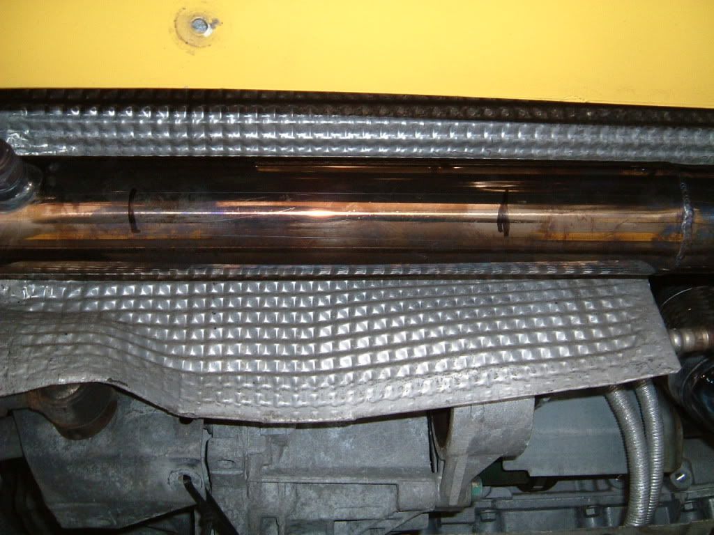

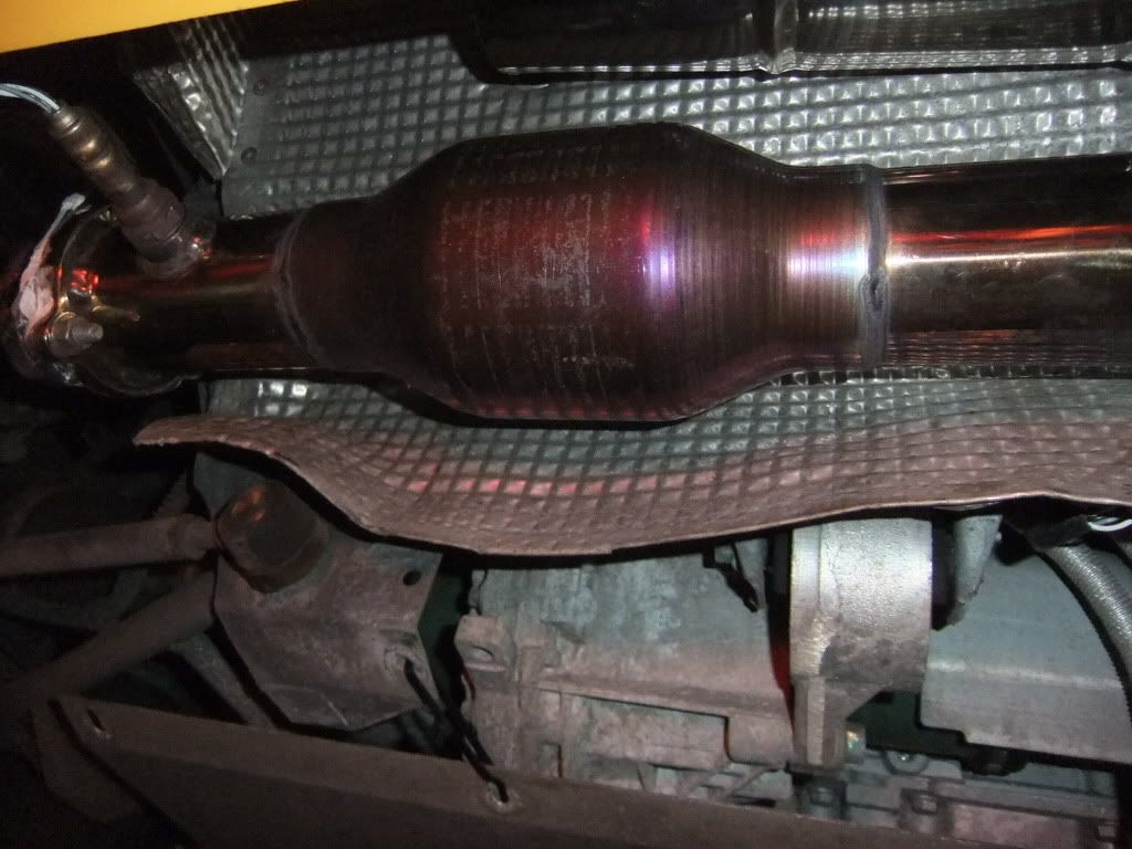

I've got a Larini back box, Larini de-cat downpipe (No pre-cat) with a standard manifold & ITG carbon induction system. I got a 200 cell sports cat welded into the de-cat section of the down pipe (see pics) which made it sound better & not so 'farty'. It still pops and crackles on the over-run, in fact it sounds bloody amazing & Im forever getting comments about the noise it makes! :)
Before
After
#12 Guest_Loadstar (Guest)

Thanks LordBenny That really does help me make my mind up. Lovely sound.

Just to let you know that the 200 cell sports cat came from Hoffmanns (http://www.sportcats.co.uk/) It's a 2.5", 200 cell sports cat, £105.

Yes it's fine for MOT and the EML light stays off!
Apparently the 100 cell cats don't have any issues either but I didn't want to risk one.
