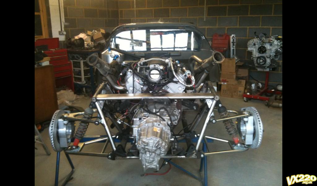

#9 slindborg
Posted 12 September 2011 - 08:18 PM
power != handling and vice versa.

Posted 12 September 2011 - 08:23 PM
this is on the elise, its the s1 i think. could so easily be a vx :)
this has got to get you excited!

#14 Nev
Posted 13 September 2011 - 08:37 AM
