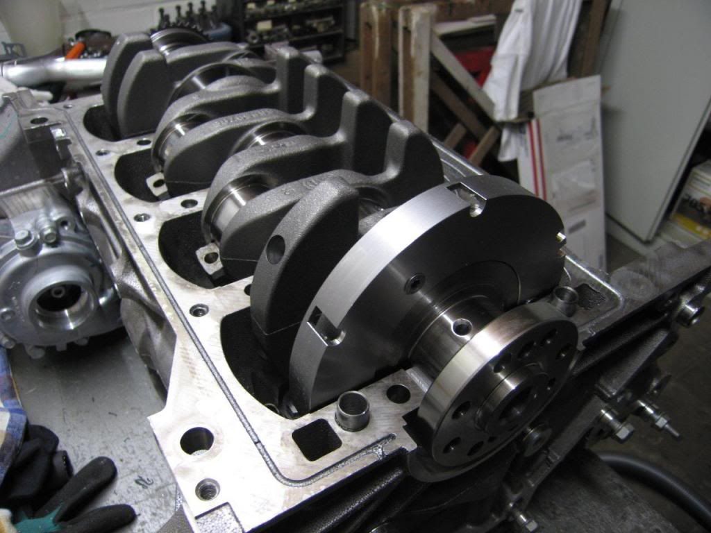

Meanwhile somewhere in a Dutch shed...
Dominique...)

#88 Exmantaa
  • 3,982 posts
Posted 30 January 2014 - 10:55 PM
Remember that you must disassemble the complete engine to fit this! And assemble again with new TTY bolts everywhere... :sleep:

#90 techieboy
Posted 30 January 2014 - 11:03 PM
More seriously, that looks like quite a chunky bit of kit. How will that affect the balance of the crank?

#92 Exmantaa
  • 3,982 posts
Posted 30 January 2014 - 11:11 PM
@ Smiley; see you mail from Rob... :sleep:
Techie; it's a tiny bit thicker than the stock pressed wheel to keep it steady in the lathe, but not much. Only looks so sturdy by the machined surface.
Dominique can give more details on it
