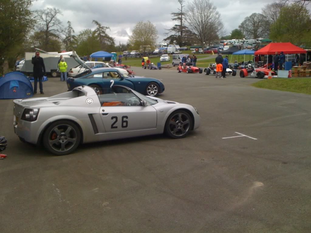

Anyone else done this, or can calculate it any more scientifically before it's too late to change my pads order? :huh:
http://i902.photobuc...otonPark001.jpg
plenty of people used to run with Pagid RS14 front (~0.5 mu*) and RS15 rear (~0.6 mu*) in the old days, but CL stuff seems to be the poulaar choice these days.
