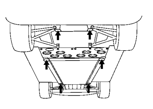

Is there a photo showing where the point at the rear is?

Can you get to the rear end jacking point without taking off the undertray? sorry for the dumb questions but i dont want the mechanic to do it wrong.

And no, you need to remove the undertray to get to the rear jacking points.

You can jack on the wishbone if you don't want to get the undertray off.
