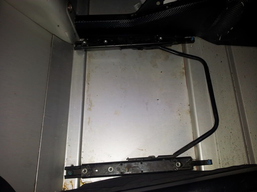

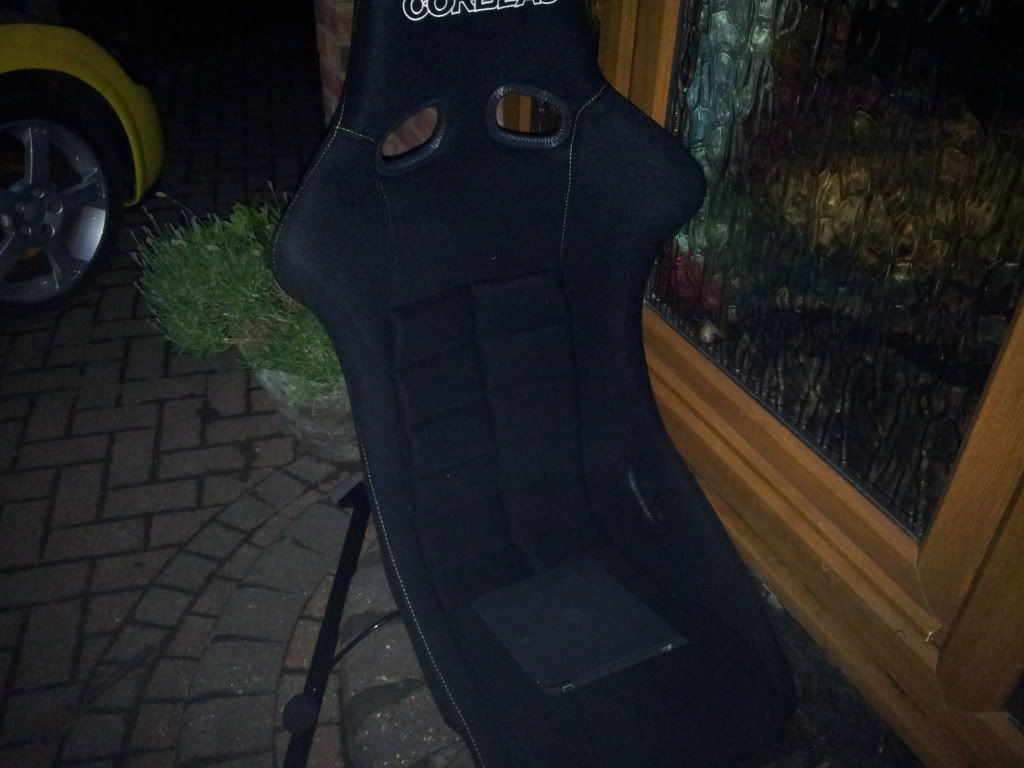

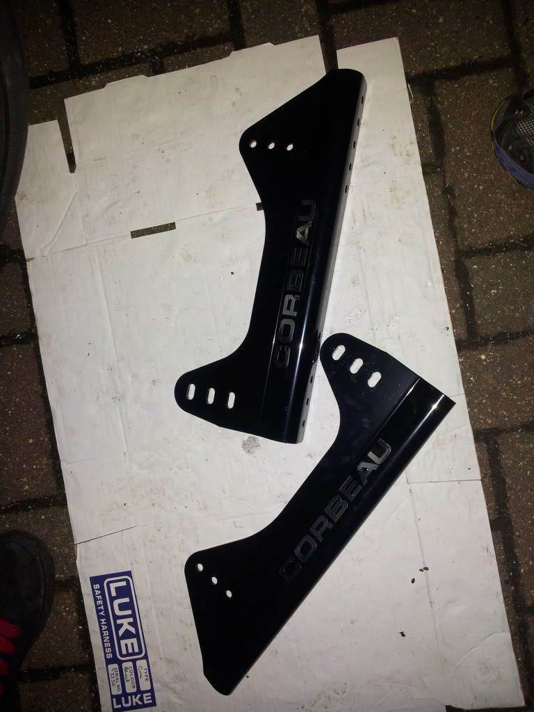

#12 Andrew aka Stuwy
Posted 07 June 2012 - 10:01 PM
Myself and Lee are having a right fcuking mission getting these into his car..
These are the bit we have to play with.. any ideas on what we are missing or meant to be doing?
1. Standard subframes
2. Seat brackets
3. Seats

#17 Arno
Arno
  • 1,238 posts
Posted 08 June 2012 - 05:39 PM
2. Seat brackets
3. Seats
Not going to work. AFAIK are these 'LE-driver' seats only meant to be fitted with special fixed frames and even then you can only fit 1 seat as the 'wings' are too wide to fit 2.
Eg. the frames in the back of this document:
http://www.billswebs...ointHarness.pdf
Only the Corbeau LE-X and LE-Pro series are a direct replacement and can be fitted on the original runners.
Bye, Arno.
#18 Andrew aka Stuwy
Posted 11 June 2012 - 02:34 PM
2. Seat brackets
3. Seats
Bye, Arno.
thanks very much for the info... this is why we are getting no where
