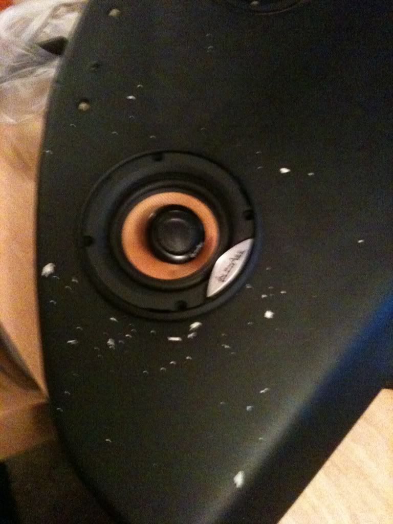

Here you go... Think mine were the 4" inPhase actually:

so doing some chopping is a must then by the looks of it, mine has recently been recovered in alcantara so bit reluctant to hack away too much if im honest.
