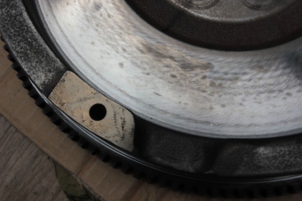

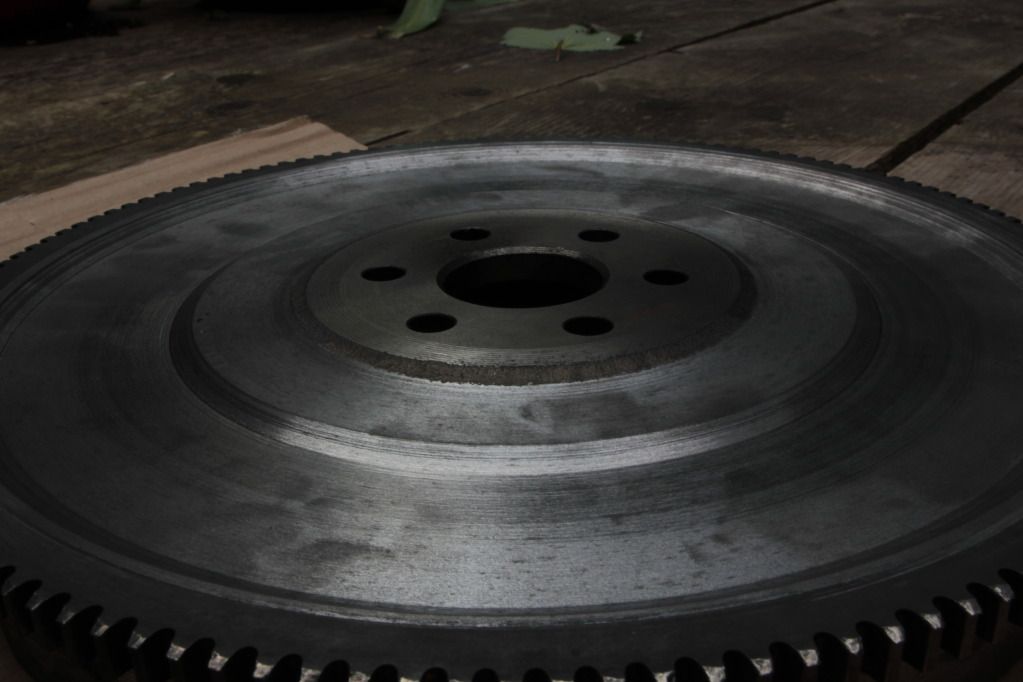

Couple of snaps of whats been done.Posted ImagePosted ImagePosted ImageNo I didn't take a picture of what it looked like before.
I do know that it weighs less and it is now balanced and true.
Will post my feelings of this latest mod once rebuild is complete.
