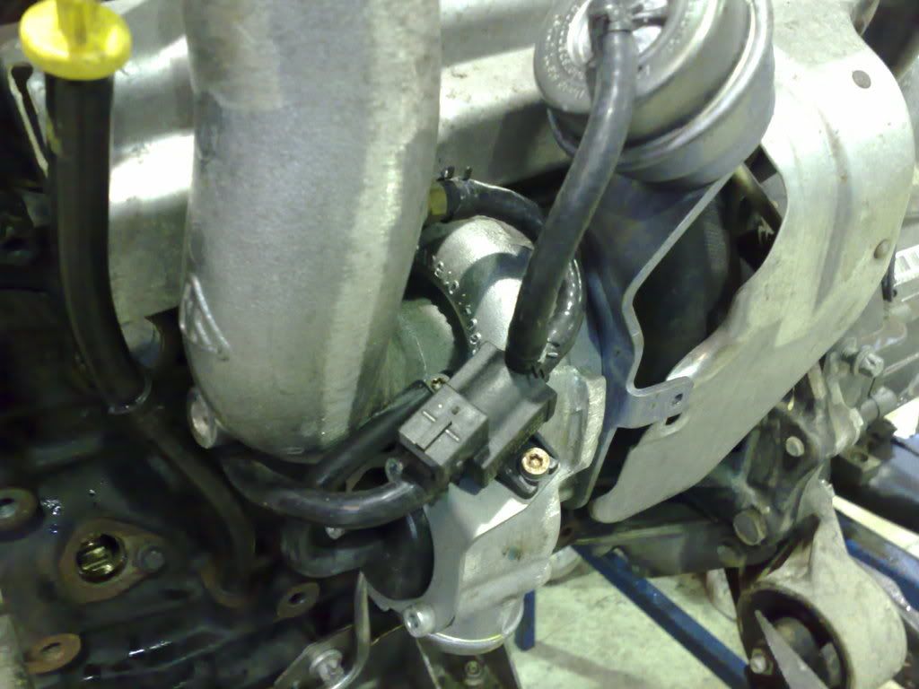

it has two systems ,
1) a solenoid mounted on the turbo that controls boost pressure to the actuator, this opens/closes the wastegate.
2) a solenoid on the inlet manifold that controls stored vacuum fed to open the recirc valve on the turbo compressor, which allows excess output boost to be fed back to the input side of the compressor through an internal pathway. In the pic above, its rubber hose is just shown turned 180 and tucked away, its normally fed by a larger bore hard plastic hose.

excellent photo STB thumbsup
#14 siztenboots
Posted 31 August 2012 - 08:31 AM
that photo is from a GSI, the heat shield is different, tempted to mod it for the VX , the hole on the left is where the crankshaft sensor should be, the toothed trigger wheel is just visible.
