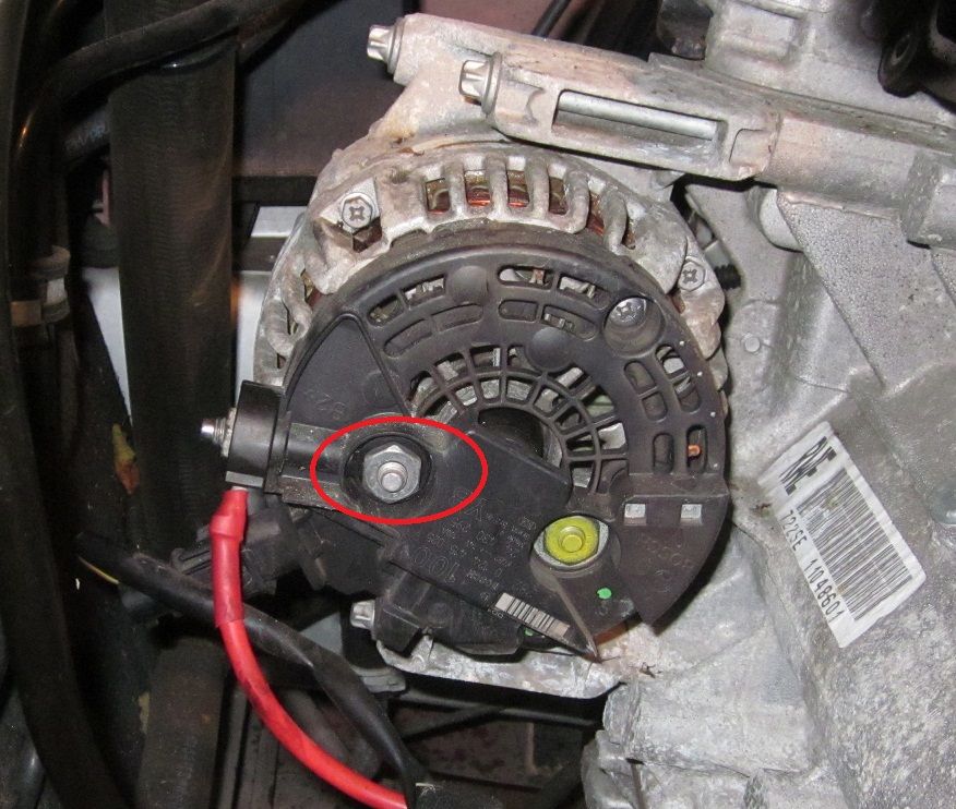

I take it that I have a 100A alternator then!??!? It has a 100 on it at least :P
Im presuming I need to grind down the post circled in order to avoid the inlet manifold? Also, what is the chat about fitting a suppressor? Doesnt it have one already? Any info much apreciated. Cheers
#2 CocoPops
Posted 13 October 2012 - 06:55 PM
Yep and you lose that plastic cover.

Mod the 100A cover like this for the SC manifold and you can keep the build-in surpressor:
