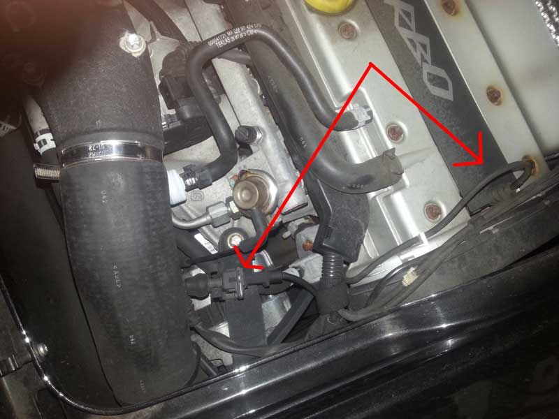

Well, he came along and gave these two wires a wangle and then it started fine.
The yellow warning light was on for a little while but went out the next start.
He told me I needed to replace the '#german technical thing I couldn't understand#'. Anyone know what that might be?

Well it happened again and it was a colleague of the breakdown guy who sorted it out last time (yes, it was within 300 meters of the last breakdown) who came over. He told me off for not replacing the bad part like the previous guy had told me to. But I told him I thought he said it was just a dodgy connection - my German is krap. He wrote it down for me as 'nockenwellensensor' which is camshaft position sensor, but it'll run without that and from his pointing by the side of the block I think he means the crankshaft position senson. I shall order a new one tomorrow. Maybe the camshaft position sensor also just to be on the safe side.
