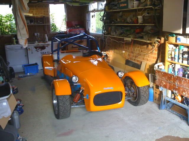

i got offered a old 750 motor club race car that was built by Shawspeed who supply my engine parts, this was the state of the car when i went to view it
gave it a good scrub and removed stickers
the car had some nce bits, quick rack gaz coilvers, quafe gearbox just needed a engine and loom!

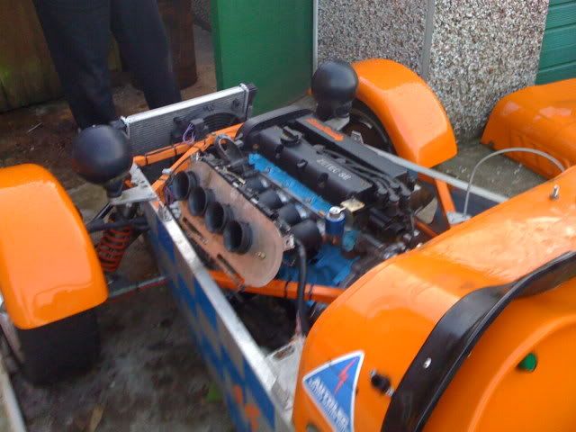

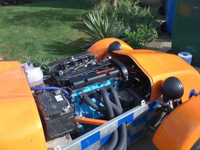

one engine
in car
done ready for rollers
down to track and road in essex for the two steves to do there magic

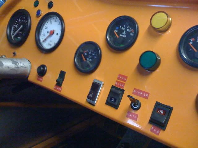

gauges all fitted
tracking done
then out on the road for my first experience of 520kg and 175 bhp and my first time driving a RWD car
i can tell you that it was a good introduction to RWD and one i will not forget as the car went like a stabbed rat!

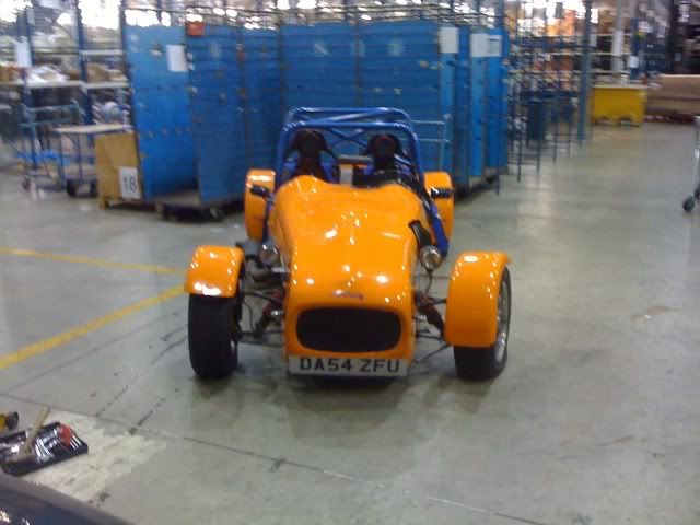

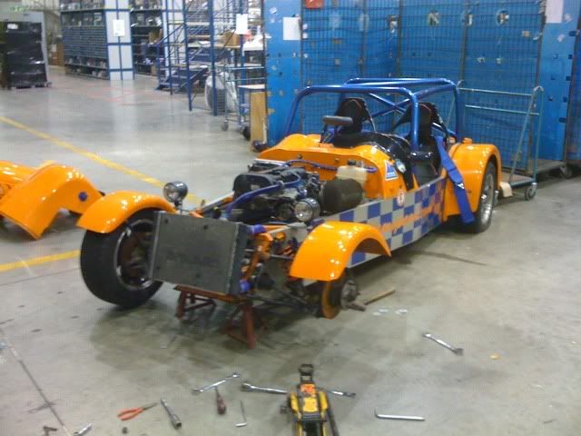

had a issue which was snapping a front wishbone under braking,
lucky for me it was on the road near work so borrowed the fork truck and went to go get it!
the damage
took ages to get a pair of new arms made and the car was stuck outside at work which wasnt great!
advantages to working at a large Ford parts warehouse, fix it at night!

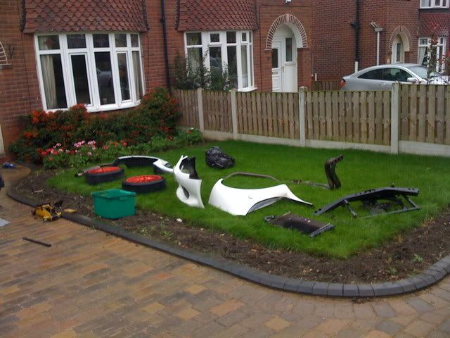

once i fixed it i got it home, for some strange reason i cannot leave things alone and love messing around
so i though as it was winter i would tidy her up a little,
plans were new bodywork chassis blasted and re powdercoated and convert it to RHD
home
in bits
started to collect new bits for the rebuild i think this is where it went wrong for me!!!!

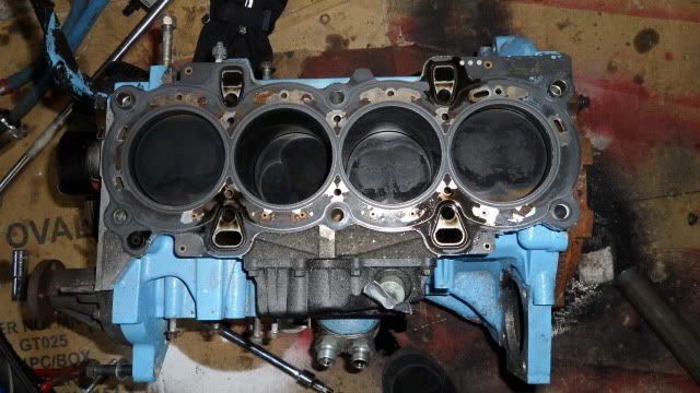

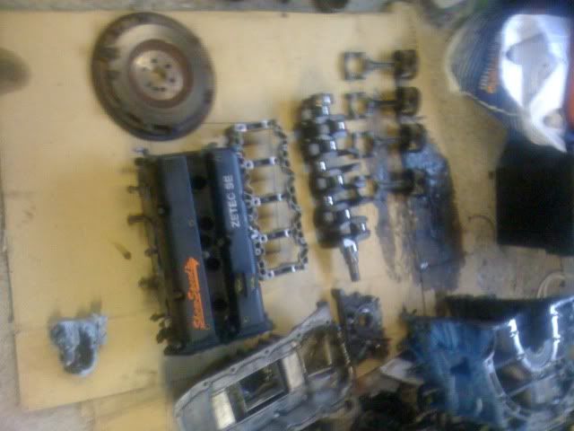

at this point i should have just waited for the bodywork but jon from Shawspeed called said he had some nice steel rods and high comp pistons and had designed a new set of cams to push the engine over 200bhp
i thought well since i am rebuilding it might a well make it go faster!
engine stripped
#15 Thealastair34
