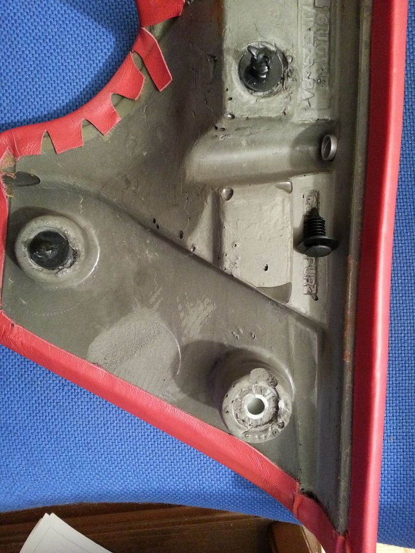

Hi all!
I'm in need of replacing the clips on the inner door trim. But I'm not quite sure on how to insert the clips into the..holder,hoping someone could guide me through it.

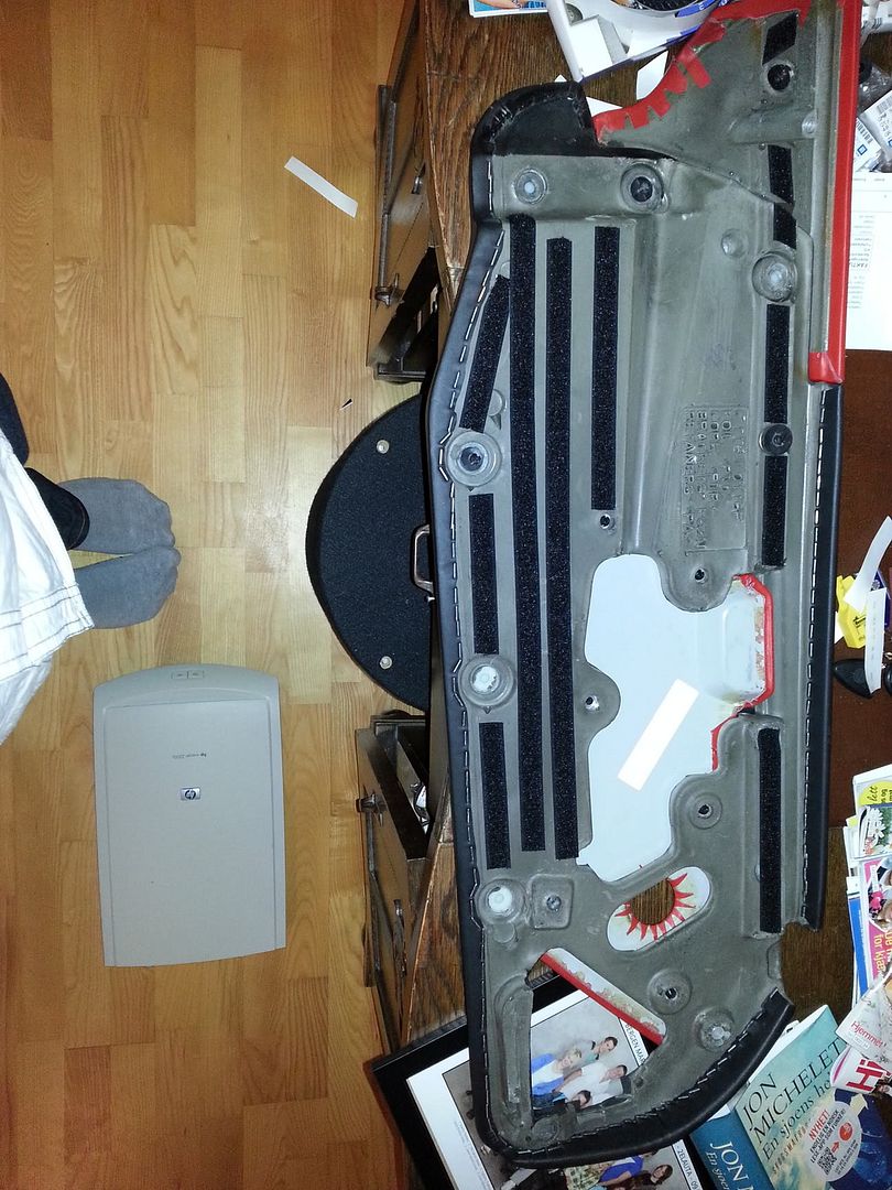

Don't bother....put back with double sided velcro. Works a treat and bloody easy to take off and put back on. If you really want them I will get the GM part number

Alright, Thanks for the reply! The easiest solution is probably the best solution :) The reason for taking the trim off was due to replacing the wing mirror and losing all the screws in the window gap.. I'll go try it out tomorrow!
I did this, cost £2 from b&q and really has worked a treat, any adjustments are now a 5 minute job.......

Don't be fooled, he means a 5 minute job that he'll get someone else to do :D Velcro, double sided foam tape, and tie wraps are essential VX kit

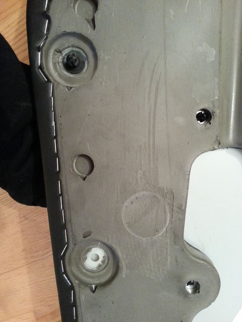

To reuse the clips you have you can trim the circular heads so they are rectangles then push back into the door trim. Alternatively, cut a quarter slice out of the circular head and "screw" the clip back into the door trim.

Posted 26 January 2013 - 04:17 PM
I think I got the hang of it now :)
Going to check how the velcro sits on the door later on this evening.
