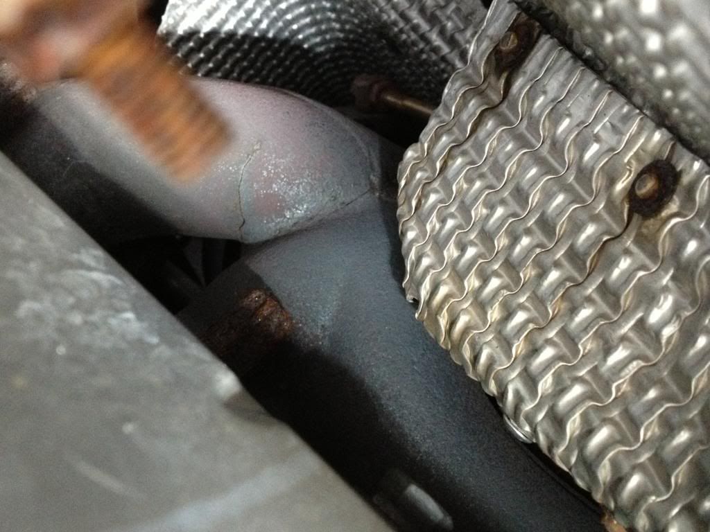

Searching for rattles and found this :(
Always make sure the car is warmed up and cooled down so it must have ben stressed early in it's life... probably!
Ordinarily I'd bite the bullett and purchase a VXR turbo and manifold but the cambelt is due next month so looking for a pikey fix! Can a new/second hand manifold be attached to the exisiting turbo?
Any advice appreciated thumbsup
ps Standard turbo with 53k miles

Pikey fix you say? get it welded.....then save for the vxr blower

A lean running engine is another likely cause for that and I believe you can swap the manifold although you cannot buy one on its own.

Yes you can attach a new manifold but it cannot be done in situ, the full turbo and mani has to come out.

Thanks all for your advice :) As the car is tracked I think a weld might be too pikey even for me! Fearing broken studs this is definitely going to be a garage job. With that in mind I guess it might be worth investing in a VXR turbo if it all has to come out to swap over the manifold anyway. Time to speak to the accountant in the house :lol:

do it yourself, other than access its not that difficult the only risk is a manifold stud could shear off

When I traded mine in they said they didn't care if it worked or not as long as they had a physical unit to send back to VXL. I'd say 4 hours labour max.

Mine was cracked when i bought the car. Bought a vxr turbo second hand for £240 from a crashed astra vxr with 3K on the clock. Very easy to swap over , the only problem is rusty bolts!! Stud was snaped on mine, not sure how to go about it but car seems fine...

We had Frosty's welded when the manifold cracked but it didn't hold and ended up getting a VXR turbo anyway.
