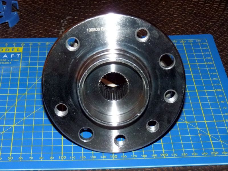

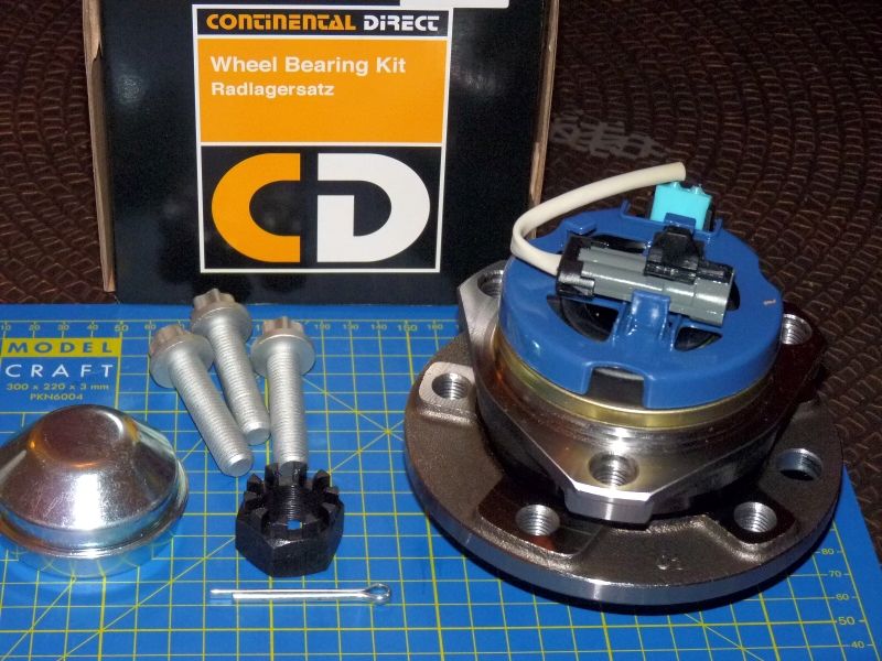

Yes, some of the cheaper ones appear to be a Bargain but choose carefully.
I think the type 1114 is the key if I remember right when I was double, tripple checking.
My thinking was you have no way of knowing if the more expensive ones are actually any better unless you strip them and check the bearings inside. The only ones I found at the time that stated the bearing manufacturer were £140 each and quoting SKF.
The only other worry is the machining tolerances which could be a worry no matter what you pay, for all we know all the castings are coming out of China. The difference being who assembles them and what bearings, plugs etc they use.
And the same unit is used on much heavier cars than the VX anyway.
Crabash is correct, 1114 is the number associated with the Hub Bearing as there have been fitting issues with others. The OEM manufacturers were SKFand FAG. When I looked on Ebay a few months ago I found a 1114 made by Continental Direct which is part of the 'Continental Tyres Group', I doubt very much they would sell the lowest quality Hubs under their name. My rear bearing had gone and I got the part for £41 delivered. No problems so far (2000 miles) and it feels cooler than the other three which I will be replacing with these soon.
The machining looks very good and uniform.

These look like the same ones I posted, same bolts and same colouring. Which seller did you get them from?

Posted 02 May 2013 - 04:39 PM
I'm not sure, the box is in the background.
