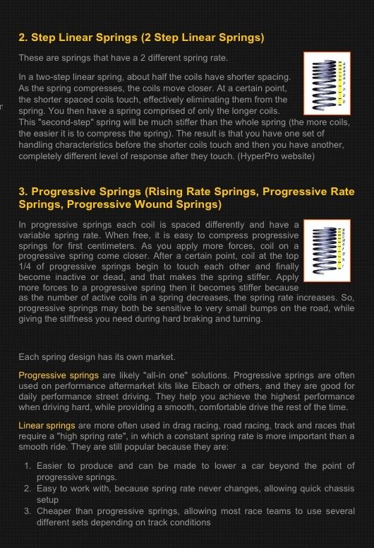

Sorry can't help but I found this

Progressive sprang are as I thought in the article aimy posted. So the rear end spring will start compressing easier than the front. Result rear end compressing before the front hence seeming more 'wallowy'

Wouldn't the rears also be acting 'hard' when under load (when it mattered), so behavior would be same. But less crashy ride at the back under low loads ?
Just reading the 3 Pros for linear posted above, they are related to greater mounting options, ease of setup and cost. Not better performance.
If the above is correct, progressive is always better if not compromising on other points ?

and we have a winner! basically, it means we can have a spring that at ride height has a lower rate than when under heavy load. ie. you get a decent compliant ride but enough rate rise to limit how far it can fall over under high loads. for the VXT particularly, this goes some way to dealing with its heavier rear stance, without having to compromise a decent ride quality. this is only at the rear as the front really never gets that same kind of load changes upon it, as well as unloading the front is nothing lie the same problem (and actually a good thing at times). doing this also enables he use of lower ride heights than a single rate spring would allow without the risks of bumping out. to my mind, i would always use this option, no downside and a lot of upsides. for the VX i would go with the higher rate variable if you ever plan on using it on track, or the low.er one for 100% road.
