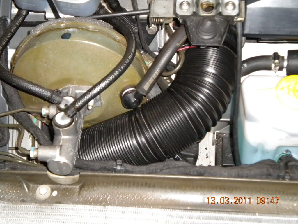

#5 smiley
Posted 23 June 2013 - 02:02 PM
Putting mesh over the 2 holes in the crash box will require the front calm to come off.
Open the front bonnet, and you will see a large silver piping in there.
(black in this sample picture)
Carefull pull it off the part that goes into the cabin, just under the windshield.
You will see a normal pipe.
From the diy store, get some mesh, which you form to the diameter of the pipe.
Put it in, put the silver piping back, and that's it.
Clean it out once a year or so to prevent cloging.
