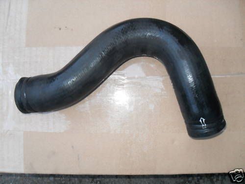

ETA:  this one perhaps
http://www.ebay.co.u...=item5882f37343
Or this one?
http://www.ebay.co.u...=item587f823940
Edited by FLD, 12 July 2013 - 07:56 PM.

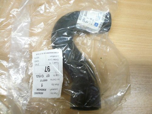

you need this:
That's an original GM LSJ top waterhose,,,  :happy:

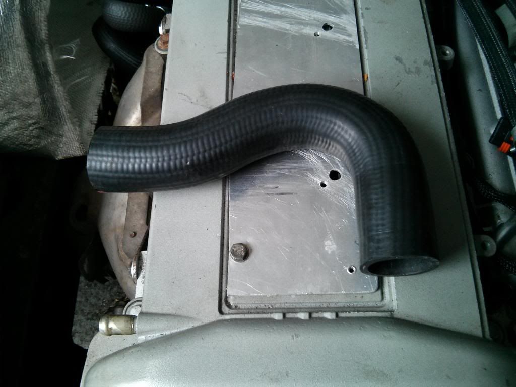

Posted 23 July 2013 - 10:43 AM
hey i found one thats even better
from an opel kadett 1.3 radiator top hose - part number RH1700 only about £10
