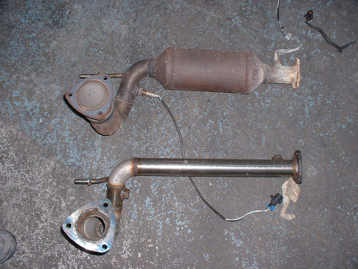

#12 smiley
Posted 14 August 2013 - 01:02 PM
Do trackdays in sweden have noise limitation? (as the 2.5" tullett will bring you to 98db isch on flyby)
Top is an oem cat section.
Bottom has precat removed (and the cat section, but you will need that)
