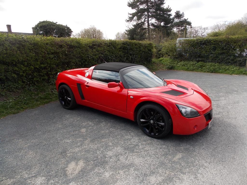

I run Vectra SRI Facelift Alloys on my NA.
They are 7J x 17" all round. I run 195/45/17 tyres on the front with 22/45/17 on the rear.
My experience with the change is the car feel more stable (particularly at higher speed) and has less understeer (although this might be simply down to newer rubber).
Main reason for me changing though was aesthetics and fancied something a bit unique

Those vectra wheels really suit your vx
Thanks pal. It should look a little better once i take it off the temporary tubby shocks and put it onto the Gaz Nickels i've just bought.

+1 for those Vectra Wheels
