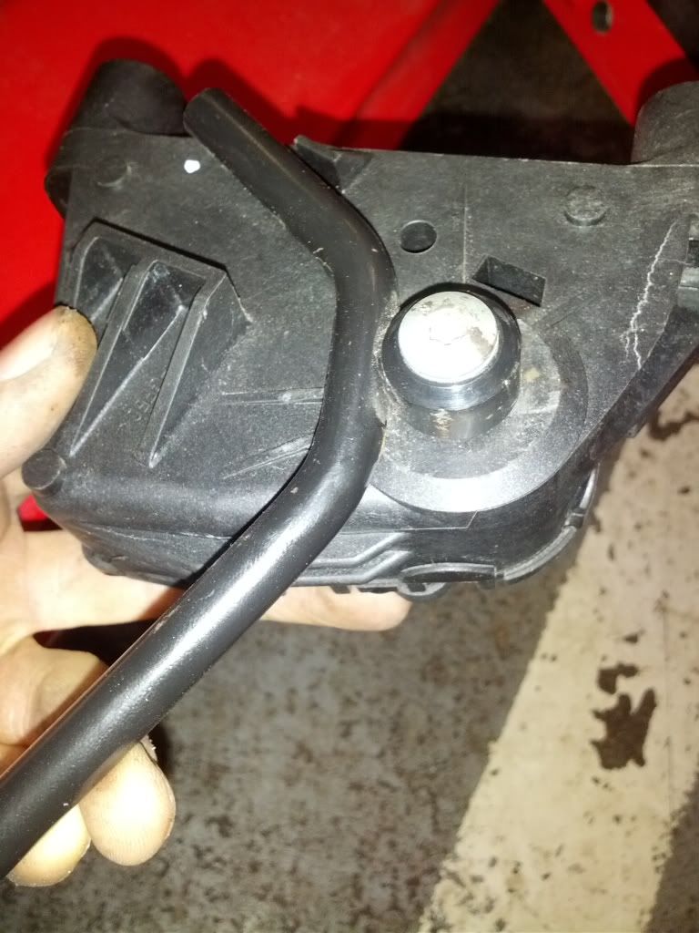

#18 Zoobeef
Posted 12 November 2013 - 04:37 PM
Finally got round to looking at this.
This is how my pedals looked from the side
Took the pedal off (bit of a pain)
Then when you remove the bolt in the picture below holding the arm on youll find its just a press fit. Pull the arm off and move it and put the bolt back in. Jobs a good en.
Granted my pedal has a bit more travel now before it hits the bump stop but will just mean the last inch of movement will already be at 100% throttle position. Ill stick the op com on later tonight to have a look.
Not test drove it yet but im hoping a moved it enough as i just guessed 'a bit'

Did this work out well? I also find the accelerator to be too low compared to the brake pedal.
#20 Zoobeef
Posted 14 April 2015 - 01:08 PM
Yeah its fine. Bending it would also have worked.
