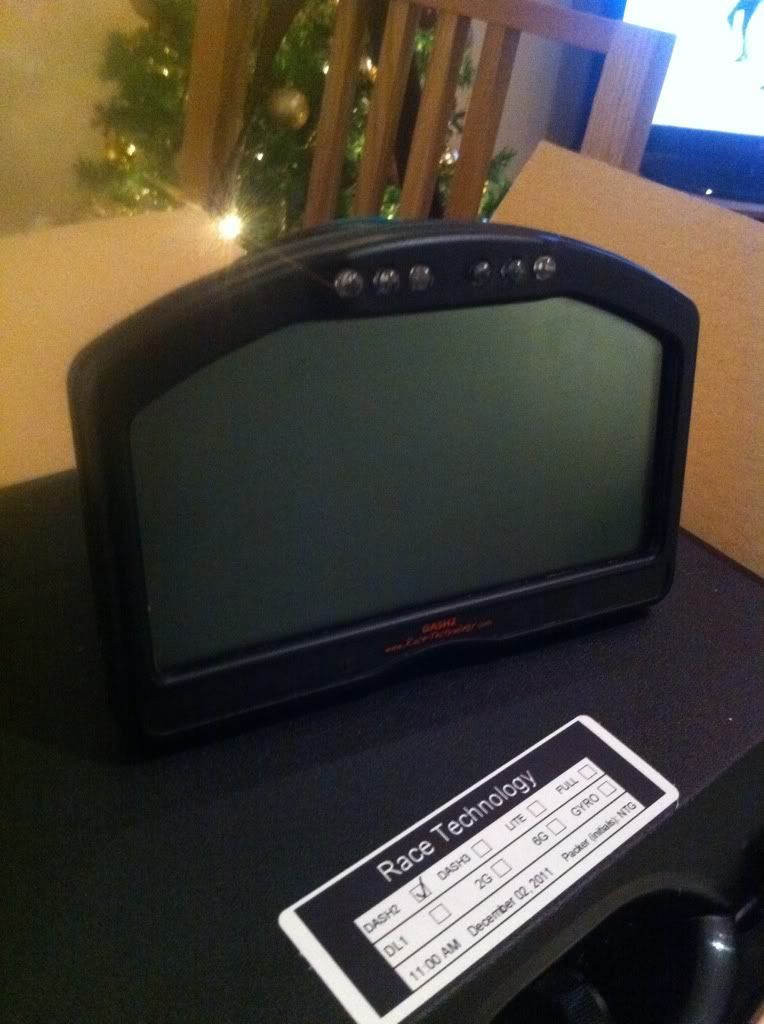

I have this little beauty kicking about from my last project and I'm thinking it would be a nice addition to the VX. Is anyone running one on a turbo?
Speaking to Race Technology they have told me that their plug and play kit for the Elise should work as apparently the looms are the same. Is this true? I see that vauxhall didn't see fit to spec the VX with a CAN interface which is a shame. Would have saved a load of hassle!

The owner of race technology has a vx220 turbo, so will have given you the correct response

Love to see a pic when this is installed! Looks sexy!
