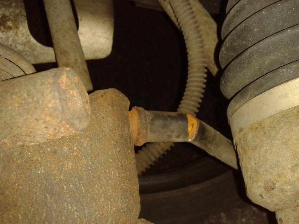

And another one. The insulation appears to be split on this here:-
Is this the brake cable or the brake pipe - is this dangerous? There has been no fluid leakage - I am assuming it is the brake cable from TIS.

handbrake cable has the split, buy a Lotus one unless you want to pay triple the price at the vauxhall dealers

Is the brake cable dangerous as it is - I have taped it up for now. If I change the brake cable have I got to replace the
whole length to the handbrake handle? Does that go through the sill?

That handbrake cable needs replacing in reality. They are only about £25 and are a breezr to fit. You only need to remove the middle undertray as that cable just loops from one side to the other, pulling on the primary cable under the middle undertray.
I wrote this guide a few years back that should help you decide whether or not to do it, as well as to show how easy it is to diy.
http://www.vx220.org...lacement-guide/
