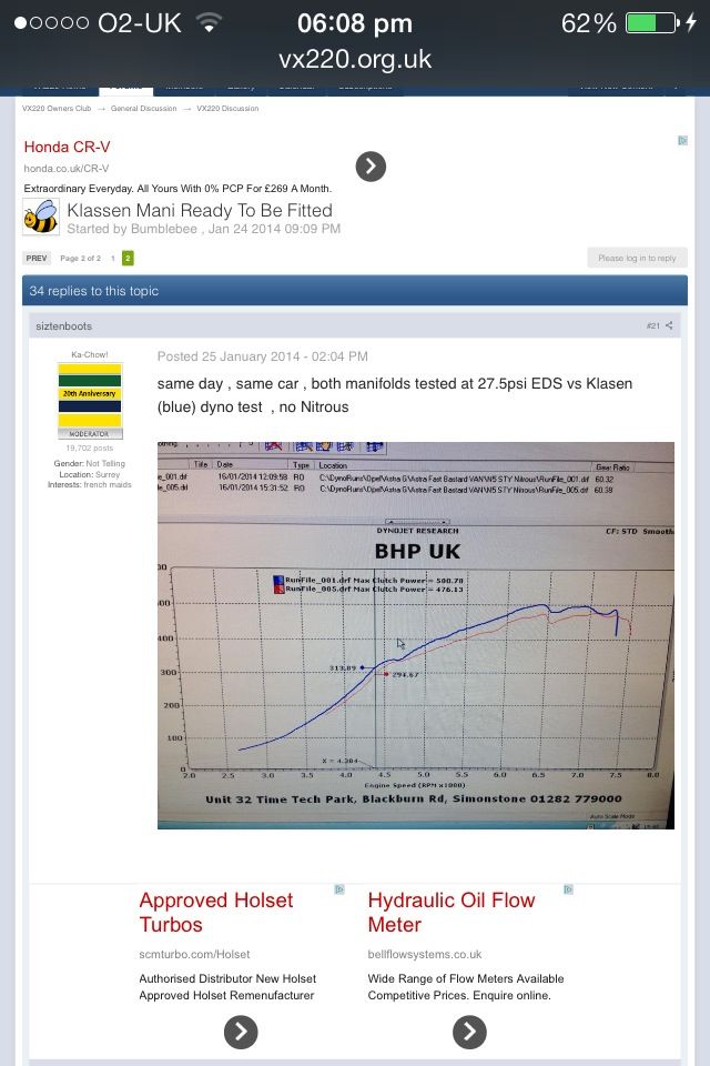

Last week I visited Klasen in Germany. They also make a inlet manifold for the Z20LET.
Since I have the EDS one fitted I asked them what are the real differences?
Klasen:
More torque in lower rev ranges
More horsepower in middle rev ranges
EDS:
More torque in higher rev ranges
More horsepower in higher rev ranges
This is because of the design of both, EDS has a short "channel" and the Klasen one longer ones!

Someone posted a dyno comparison with eds vs Klassen (think it was Siztenboots? )
