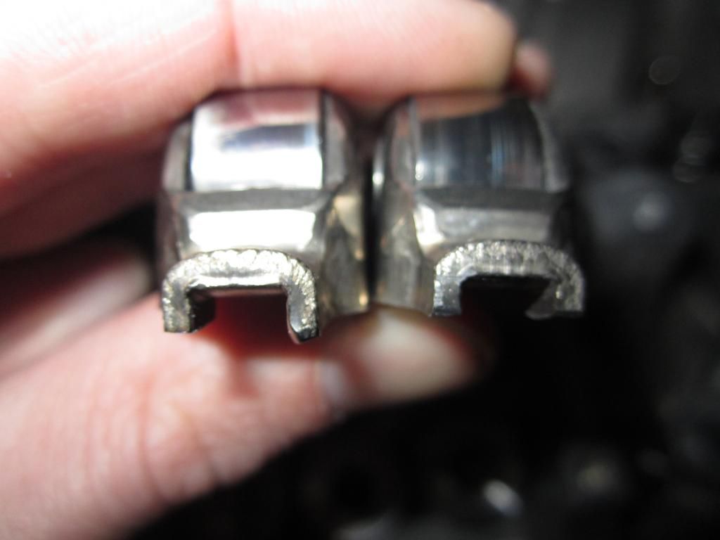

#17 FLD
Posted 11 May 2014 - 05:18 PM
Now look like this
However, be careful when grinding them.  They are proper soft!  I did it on a bench grinder and took some material off the tips on two.  Should still be OK to use as the load point is actually quite far back directly under the vertical bit where it comes down from the roller.  The two I over ground look like this.
Being rather particular I ordered 2 new ones to replace them and ended up with cast ones.  Here you can see the differences on the bottom of the rocker.
the cast ones have plenty of clearance so I might get a full set.
When you do grind them the filings go into the needle bearings of the roller and you can feel it gets gritty.  They will need cleaning out very carefully.
