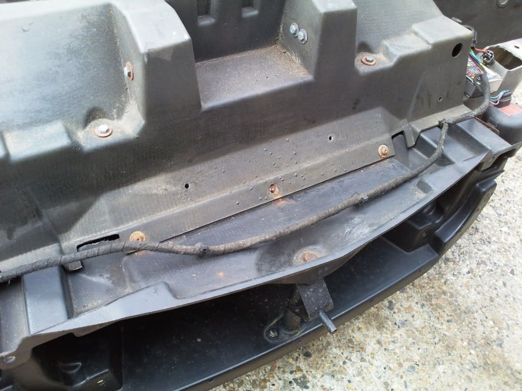

#5 fezzasus
  • 7,689 posts
Posted 23 May 2014 - 05:46 PM
Yup, through the hole on the right hand side here:
#6 Jester666
Jester666
  • 115 posts
  • Location:South Wales
  • Interests:Fast cars, Superbikes,real ale,Elite Dangerous
Posted 23 May 2014 - 05:48 PM
Just a thought how do you get the jubilee clip on the rad end of the hose ? Is there enough room to get a 3 year olds hand in to hold it as you get the hose over the rads tube ?
#7 fezzasus
  • 7,689 posts
Posted 23 May 2014 - 05:50 PM
there's enough room to get it through the hose hole.
