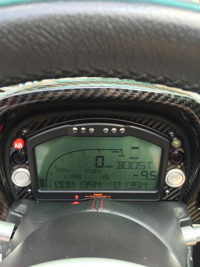

Hi all, just thought I'd share another picture of my Dash 2 installation; the all important view through the steering wheel!
It's really lifted the look and feel of the interior. It's made a special car feel just that bit more special.

Stunning!

Thanks for your feedback guys. I've finally finished the entire set up. Until yesterday I still had issues with the fuel reading, the figures moving about during acceleration, braking and cornering. It took a lot of trial and error to slow the numbers down enough, but not too much. It's easily done through the laptop, but no reference point as no other VX owner had done the Dash 2 mod. At least not to my knowledge. But I'm thankful it's finally done and very very accurate in all areas. It's great that you can fine tune and calibrate everything to get it all spot on.

Top work!  I reckon you could have a nice little sideline of installation and setup for other VX'ers ;)
