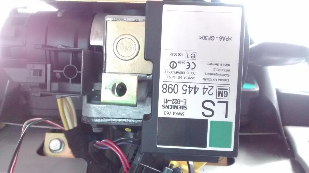

Next question.. How do I get the transponder off. I have removed steering wheel airbag etc. But the plastic underhanging transponder won't budge. Do I need to use the key in a certain position or pock a small tool in a whole somewhere?

Posted 12 September 2014 - 04:41 PM
You need to put key in ignition barrel turn to position 1 ,there is a small hole under the barrel surround put a small screwdriver - bradell in the hole and push up be carefull as you can brake the retaining clip that holds the barrel in .pull barrel with key in ,once removed the transponder with metal surround should pull of .unplug and change ;-) good luck lol

Posted 12 September 2014 - 05:28 PM
Now I am waggling a 2mm allen key in what I think is the correct hole, car to confirm if its this small round one through black plastic? (pictured on the left close to white wires and looking like a sight for a riffle)
Dont seem to press anything inside though the hole only opens when ignition barrel is turned.  How come the simple sounding things are so difficult..

Posted 12 September 2014 - 06:13 PM
the transponder just clips into place, no need to remove the lock barrel, simply lever off the transponder
