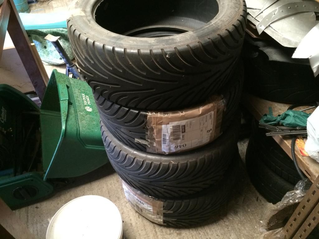

#6 chris_uk
Posted 02 November 2014 - 09:00 PM
You need these
