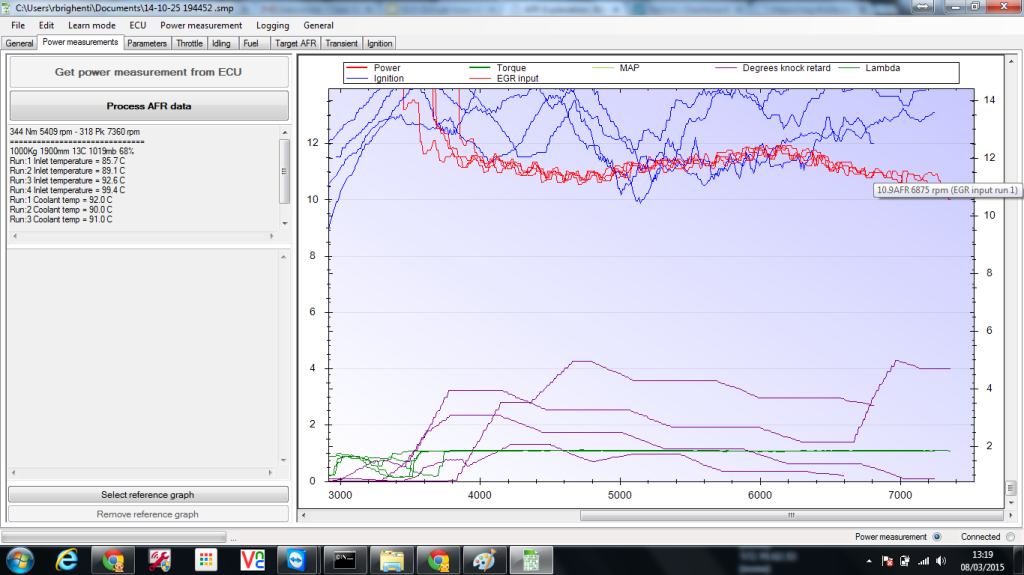

what is it in the logs what shows it's maxing out?
Might have to look at mine!

#9 Bargi
Bargi
  • 4,483 posts
Posted 08 March 2015 - 01:46 PM
This was done before I'd fixed the charge cooler pump relay which is why the IATs are so high.
Even the 4th run at 99 degrees AFR was well below 11 so plenty of fuel there.
When I had the CS map I'd maxed out the Turbo injectors and running lean produced more power.
Once I'd upgraded to the Blue VXR injectors I actually lost 5bhp :D
Below is running the pulley that came with the Harrop.
#10 CHILL Gone DUTCH
Posted 08 March 2015 - 01:50 PM
Your AFR looks like it's going lean around 5000-6500 But that's the least of your problems what's happening with your knock
Edited by CHILL Gone DUTCH, 08 March 2015 - 01:50 PM.
#11 CHILL Gone DUTCH
Posted 08 March 2015 - 01:51 PM
It looks like it's retarding a lot

#16 Bargi
Bargi
  • 4,483 posts
Posted 08 March 2015 - 02:38 PM
It's on the larger Siemens injectors, the VXR injectors were the old M62/CS days.
The leanest it's running is 11.9. In the software the target AFR is 11.8
Quick google and that also seems fine for boosted engine.
Towards the top end it runs really rich which I'm assuming is because the IATs are so high and ECU starts dumping lots more fuel. That would seem to indicate the injectors and fuel system is up to the job.
#17 CHILL Gone DUTCH
Posted 08 March 2015 - 02:51 PM
yes the graph ma[color=rgb(40,40,40);font-family:helvetica, arial, sans-serif;]de it look worse than it is,[/color]
[color=rgb(40,40,40);font-family:helvetica, arial, sans-serif;]it changes up to   1.0 in software when inlet temps are that high so that looks normal,[/color]
but ignition looks very low

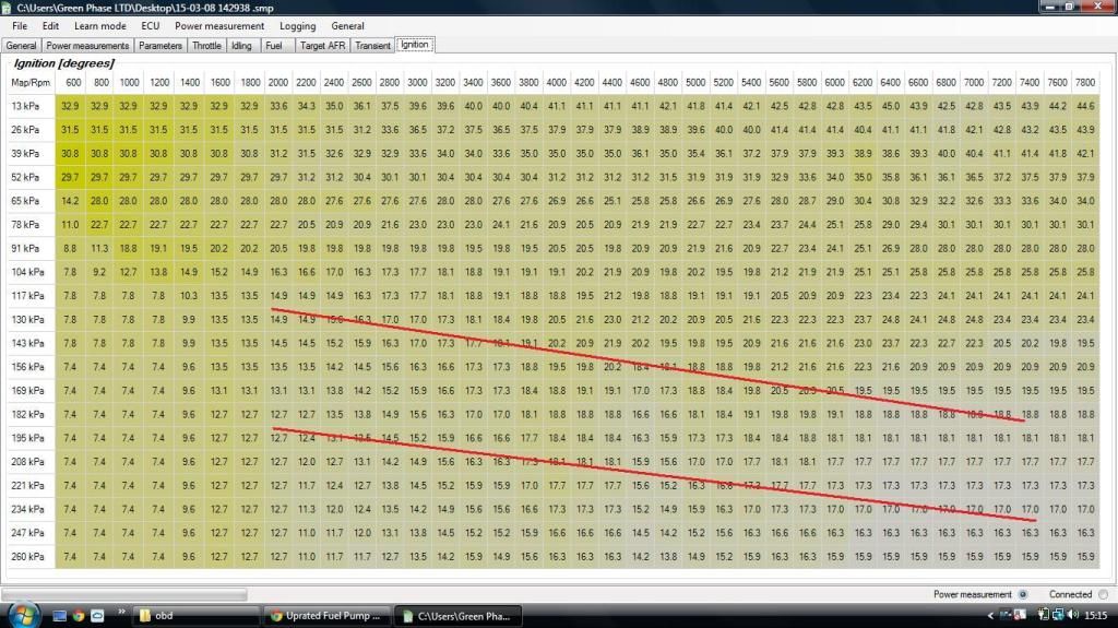

bargi your car is running approximately between these lines
#19 CHILL Gone DUTCH
Posted 08 March 2015 - 03:24 PM
i think the ignition shoul[color=rgb(40,40,40);font-family:helvetica, arial, sans-serif;]d be a lot higher[/color]

Posted 08 March 2015 - 03:49 PM
pme[color=rgb(40,40,40);font-family:helvetica, arial, sans-serif;]d you a file to try bargi[/color]
