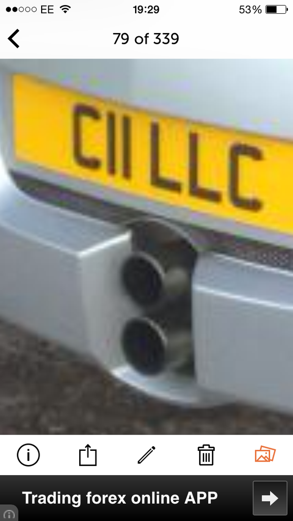

#14 CHILL Gone DUTCH
Posted 25 March 2015 - 07:27 PM
Mine is aluminium
#15 CHILL Gone DUTCH
Posted 25 March 2015 - 07:29 PM
