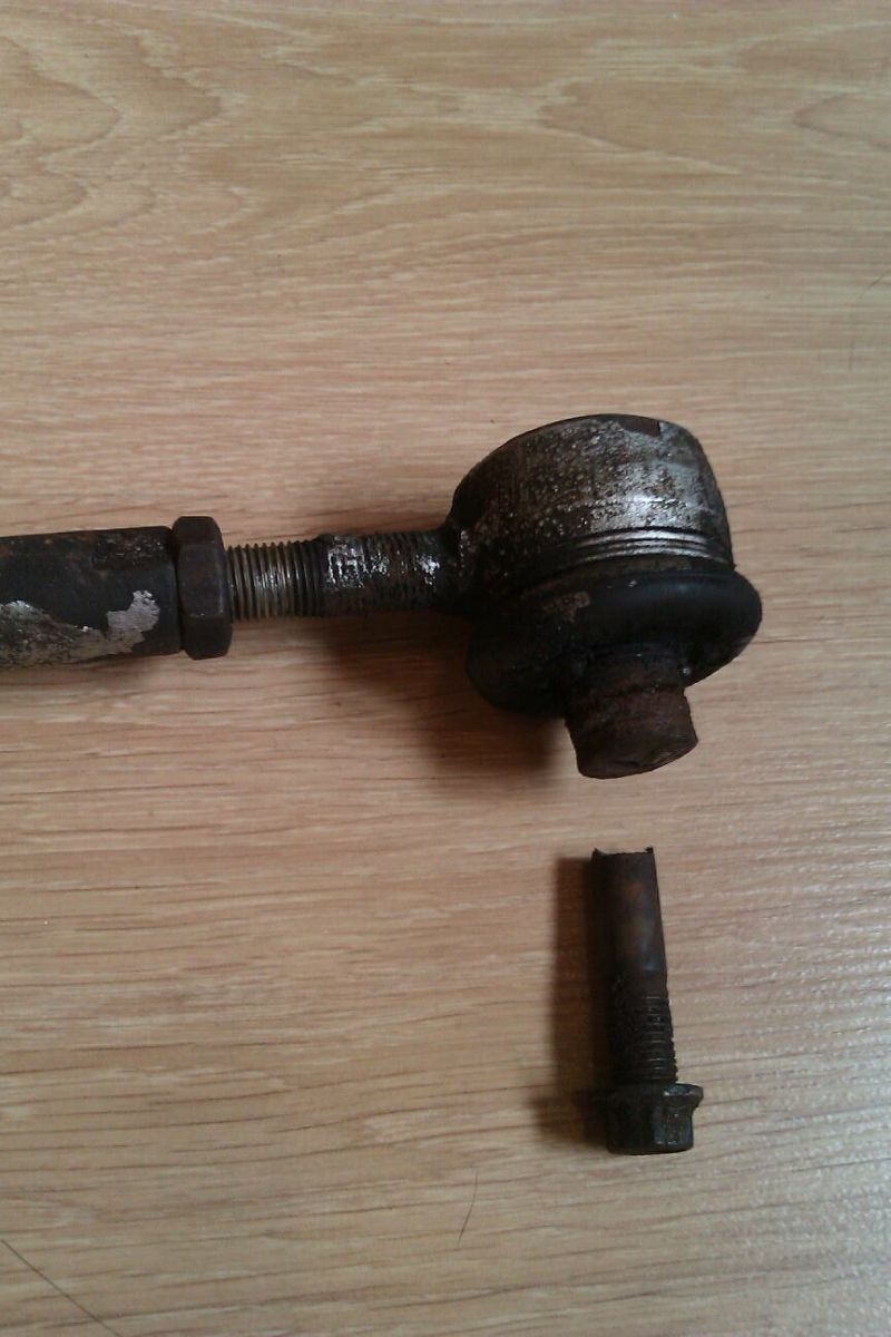

#19 slindborg
Posted 20 April 2015 - 07:22 PM
http://www.vx220.org...0_147_55420.jpg
#20 hairy
hairy
    Moonlander
  • 6,038 posts
Posted 20 April 2015 - 07:26 PM
I got one like that Posted Image
