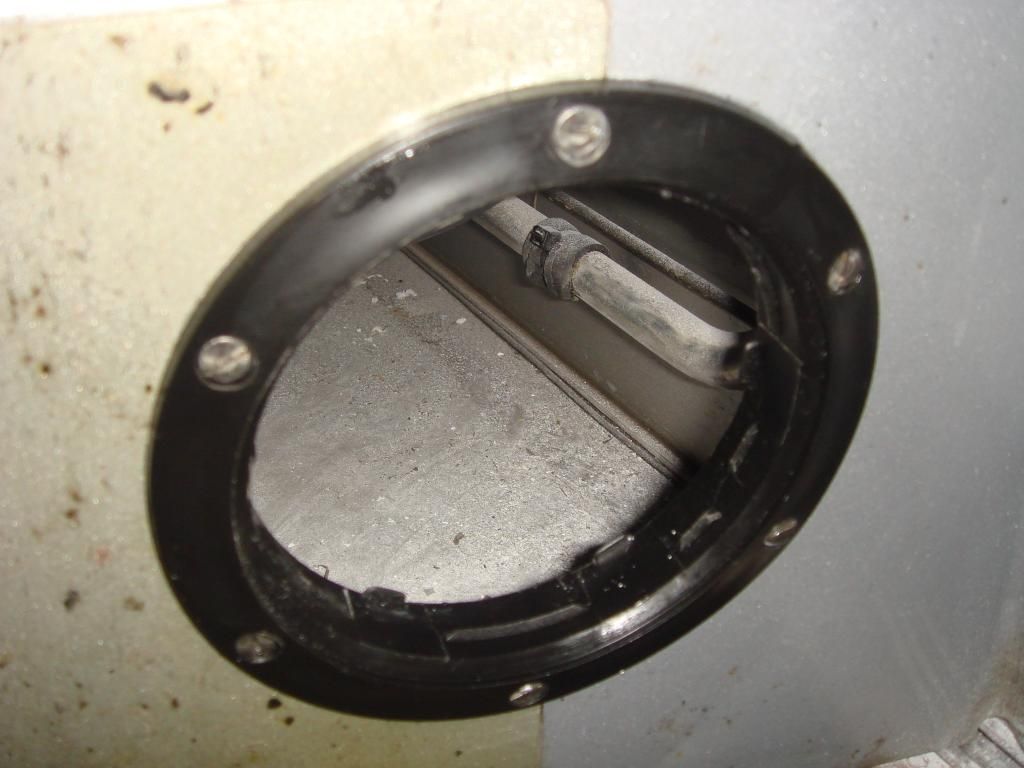

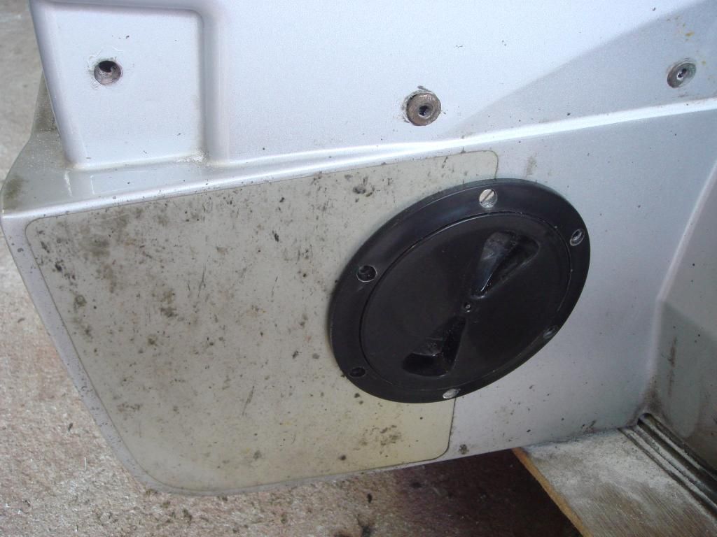

A 104 mm marine bulkhead at the either end of the sill helped me a lot with my charge cooler installation, also allows access to the brake pipes...mind you I got a lot of flak, for even suggesting it....so I guess more to come...
I think that is quite clever. Well done  chinky chinky  :)

Great ideas thanks guys. The rubber hose would help stop some of the vibration and hence hardening / breakage of the pipe. Genius.
Kipper - also a great suggestion. I'll bear that in mind if I can't get good enough access through the top.
