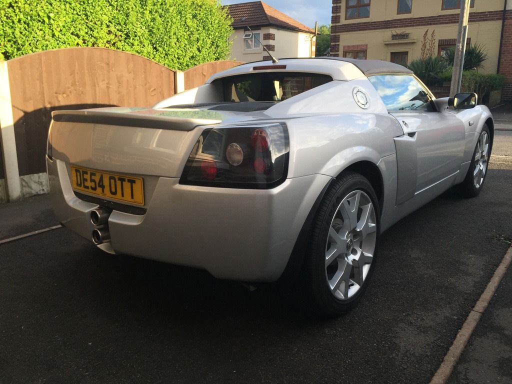

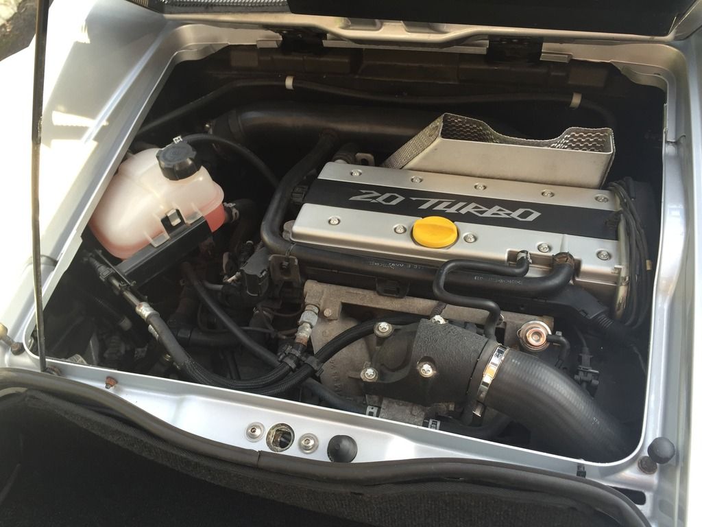

Finally handed in the last assignment for my degree last week and have been busy working on both cars since. Every night I've been under one of them. I'll start with the silver one.
Jobs done
- MOT complete (2 minors - nothing serious)
- Thorough clean inside and out
- Soft top cleaned, re-proofed and fitted
- Front splitters fitted
- Exhaust heatshield re-attached
- All rusty engine bay bolts replaced
- Saggy seat leather sorted

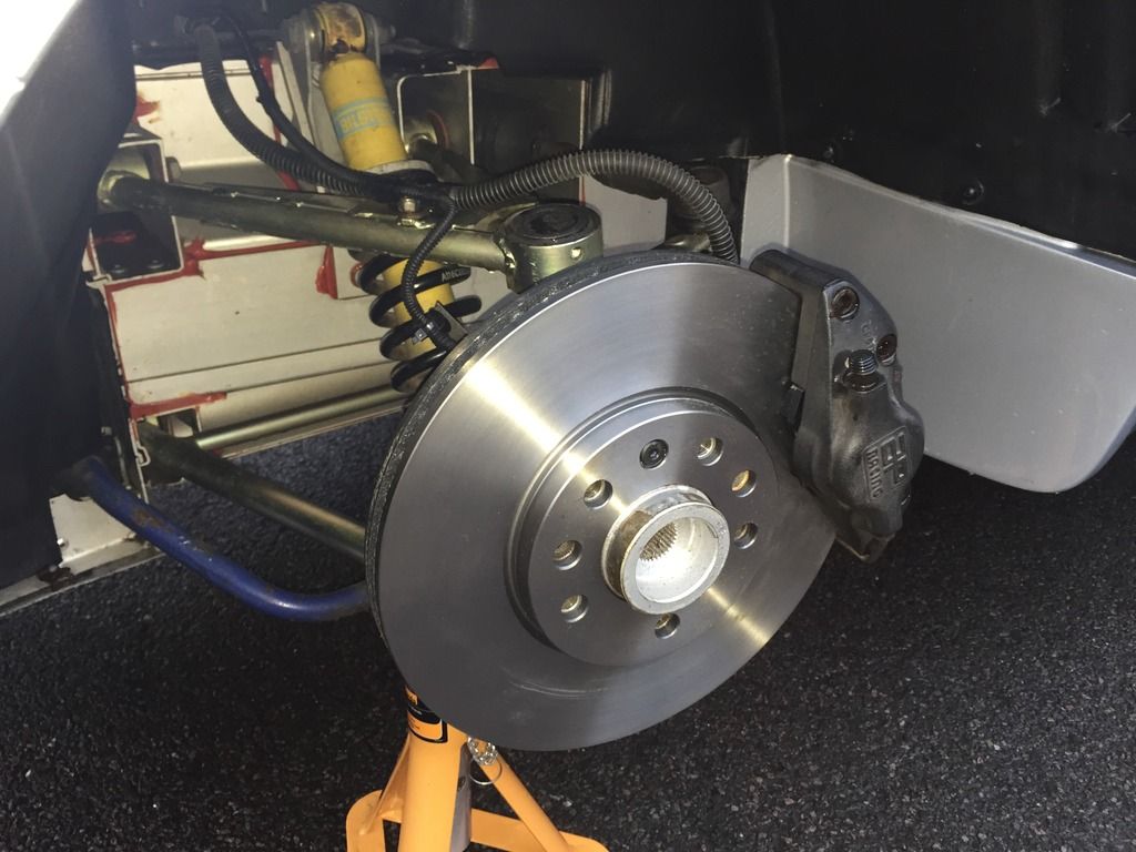

- New discs and Mintex pads all round
- Brakes bled
- New number plates front and rear
Though this is all minor stuff, the car looks a whole lot fresher. Can't believe how mint it is underneath. Way easier to work on than mine. Anyway, here's a few pics.

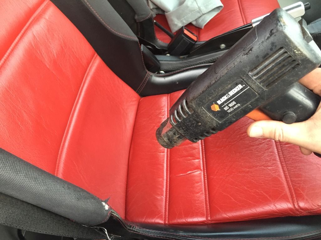

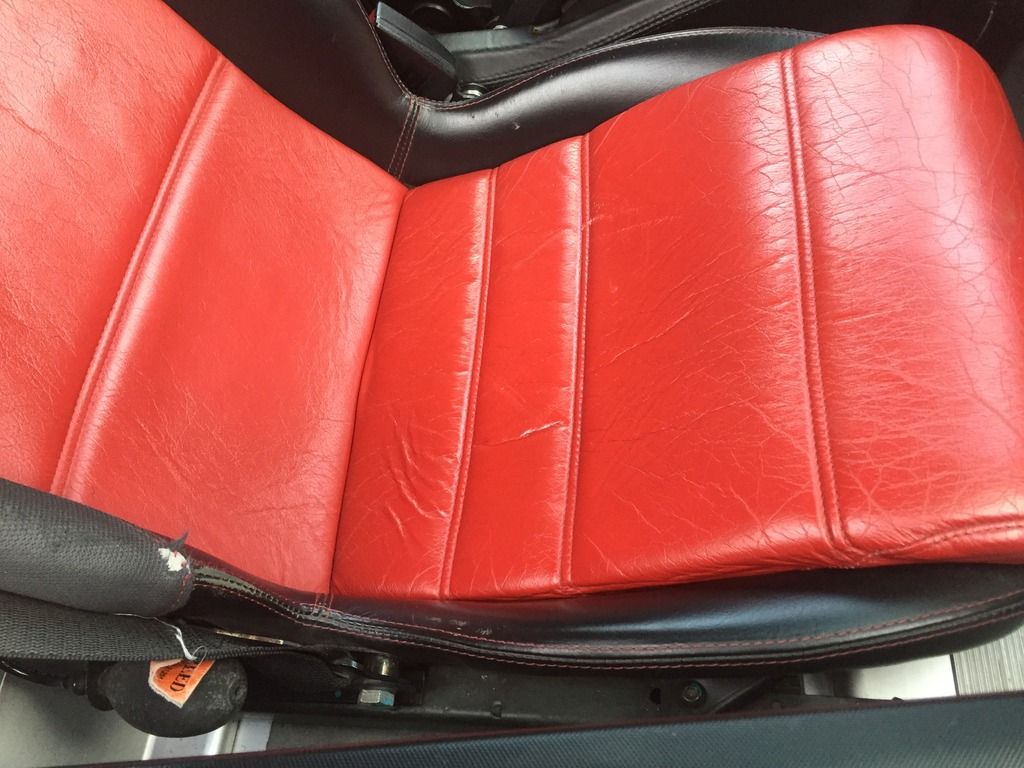

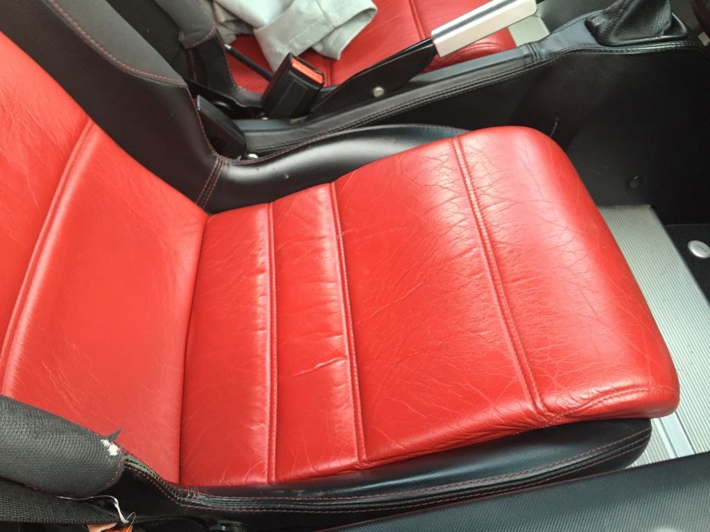

One of the things I was most pleased with was the effect a little heat had on the leather seats. It had a few creases which was surprising given the mileage of the thing. A quick blast with a heat gun and it was sorted.
Before
During
After  :)

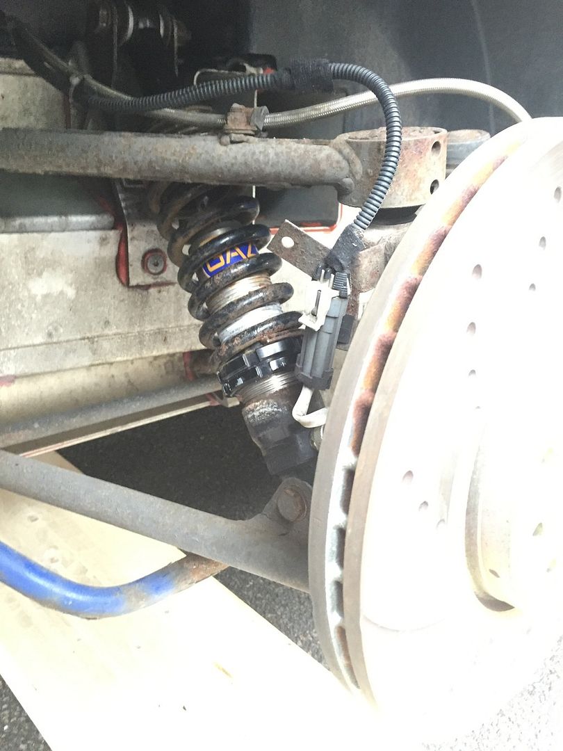

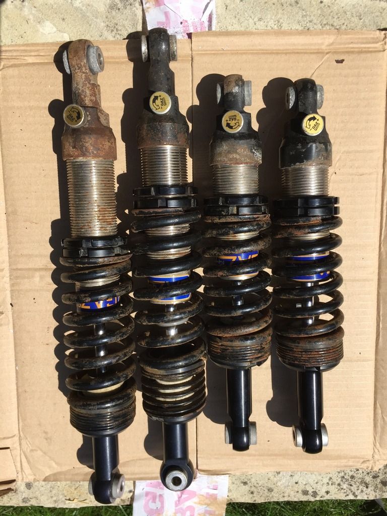

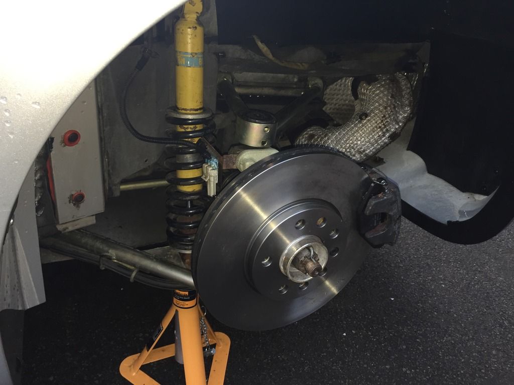

First, some pics of recent work. The Gaz Gold's arrived last week. Despite a couple of hours sleep and a horrific hangover, I jumped out of bed, greeted the postman in my boxers and then set about fitting them immediately.
Don't look anything special as they have some surface corrosion and these are temporary until I do a suspension refurb when I'll be fitting some Quantum's.
Took me quite a while to get the ride height sorted and I had to turn the front shocks the other way up as there's a stupid bracket on the driver's side and the C-spanner you get with the shock is useless as the upper wishbone completely restricts access with the adjuster at the top.
Really pleased with the way it looks although the harsher ride is taking some getting used to. I went about 25mm lower all round. It needs a clean I know.

I'm not 100 % but shouldn't the helper springs be at the bottom of the shock? Also turn the bit with the knob on 180 degrees so it can be adjusted easily

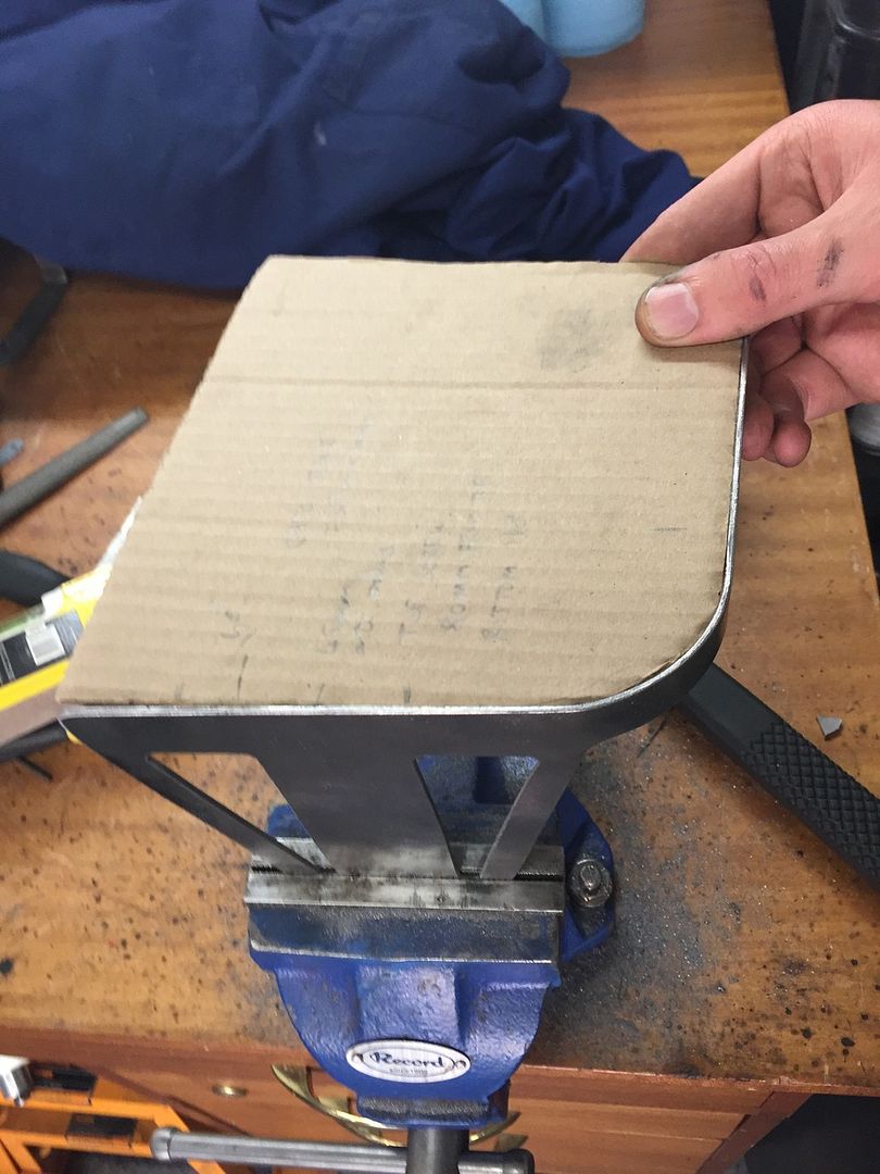

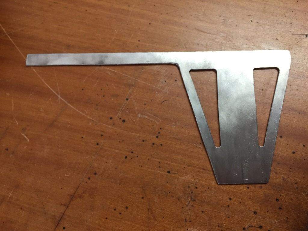

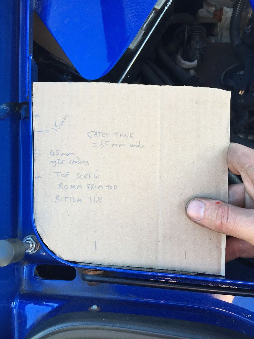

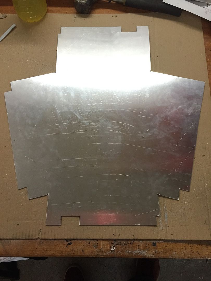

I've since set about making a bracket to mount my oil catch tank. Fortunately I'm a master of CAD (Cardboard Aided Design)
Work in progress. Trying to keep it OEM with a couple of triangles in there for 'lightness.'
Success
Just got a bit of drilling and painting to do before it'll be finished.

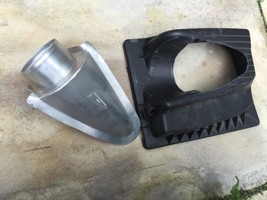

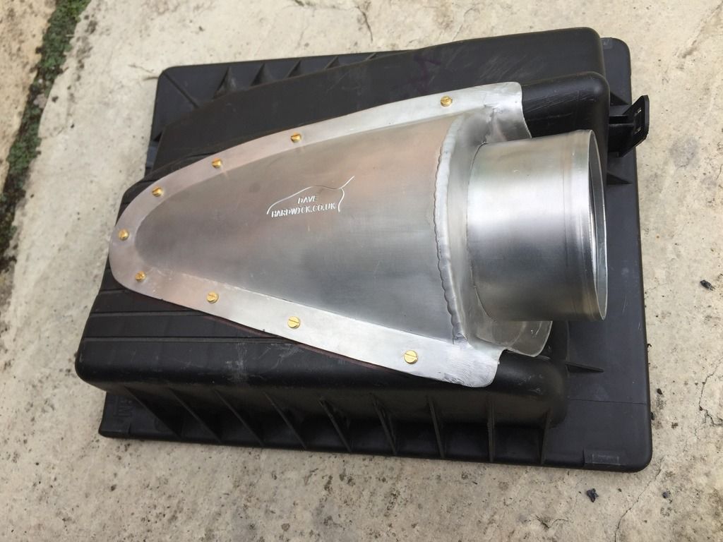

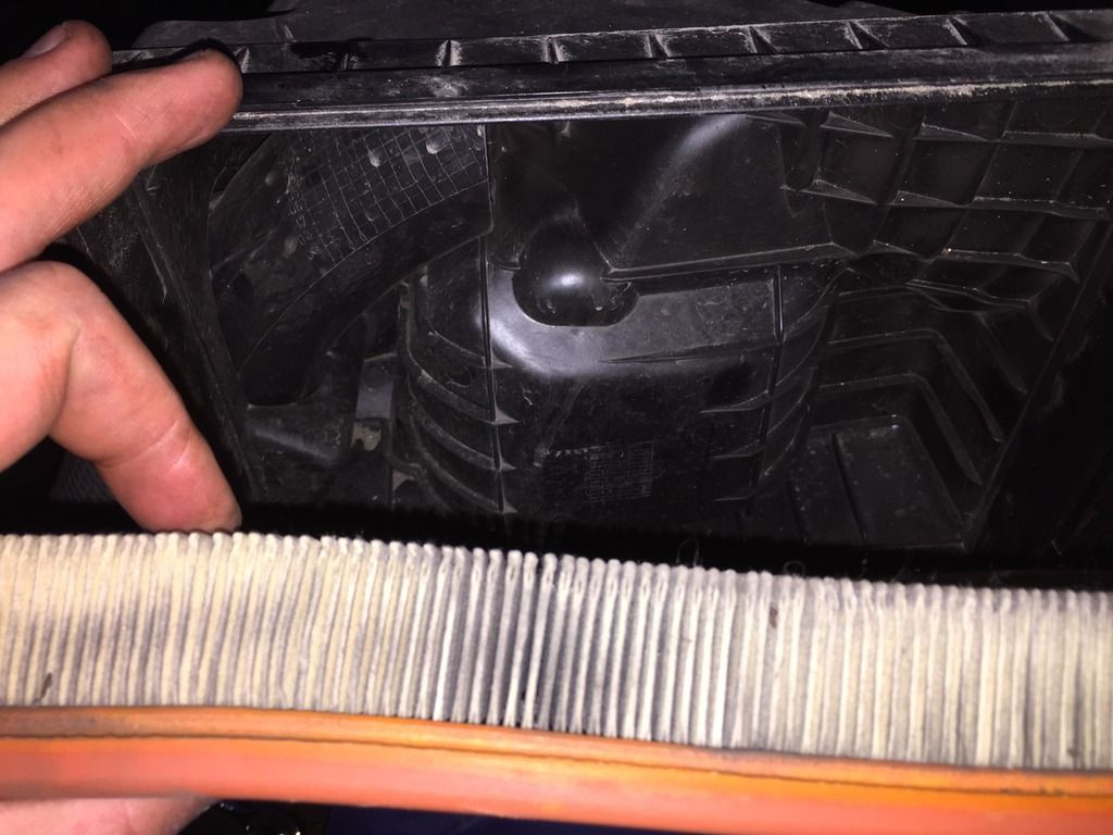

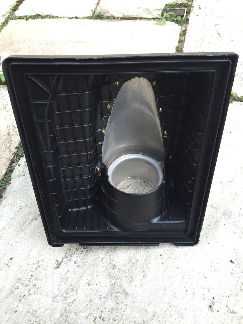

I've also been butchering an airbox to make it 80mm all the way to the Turbo. All the re-inforcing ribs have been a total PITA. Makes what should be an easy job a really time-consuming one and fiddly one. Some pics of work in progress and a trial fit.
I was prompted to make this airbox after seeing what a horrific shape the original one is. Think it's the same one used in an Astra but usually sits on top of a suspension turret. It's therefore lumpy and appears to restrict airflow to at least 30% of the filter. I wonder if this is the real root cause for intake pipes collapsing as it's essentially the same as sucking on a straw with your finger covering half of the other end. Vauxhall tried to fix this by adding re-inforcing to the pipe and it's the main selling point of the alloy intake pipe.
Honestly, who the hell designed this?
Inspired by Dave Hardwick's airbox, I've now started designing and building my own. Will post back soon with some juicy details that the Mathematicians can gorge on. Progress so far below. Is it a bird, is it a plane........?
