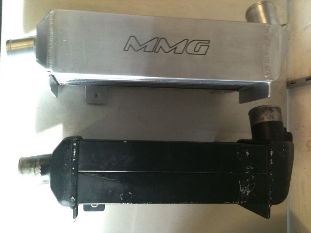

Currently £625 on ebay direct from MMG
Build
The unit is lighter yet built better than the standard unit. This IC has a better core and slightly longer in design but is a direct swap for a standard intercooler. Only modification is to chop an inch or 2 off the intercooler pipe due to the extra length of the unit
Performance vs standard IC
Well its an improvement but the inlet temp will still climb quickly with a highly boosted VXT
For standard, or stage 1 this IC is nice upgrade. Will work as an improvement to the stage 2 but that about it.
I'm running a stage 3 map and the unit cant keep the temp below 60 on heavy boost so no good for track BUT the major advantage this IC has over standard is the ability to recover and get rid of the heat soak.
Running 18PSI the temp saw to 70-80C on the inlet but lift off the throttle in just a few seconds the temp will fall very quickly to a reasonable 30-35C (summer temps) winter will be lower
Any faster?
Well it actually is! I was shocked I think its more the fact the car runs about 10% lower IC all the time (better core) and as it lower the car can make more power. High inlet just loose bhp as the ECU shuts power down
Worth the upgrade/money?
Not sure its worth £625 but certainly an improvement and it does shave the temp off very quickly after a blast up the road which helps the heat soak Stage 2 drivers suffer, and means you don't keep losing power as the ECU begins backing power off at around 55C
Overall
A good improvement for standard, stage 1 and stage 2 due to the faster recovery times (30% faster as a guess)
But if your stage 3 or 4 you cant beat the charge cooler which is exactly the advice Courtney Sport gave me, hence they wont install IC on stage 3 any more, or don't recommend them at least
Charge Cooler if you can afford to spend £1.7k + £750 on the fitting

oem 7 row
mmg 6 row
#4 hairy
hairy
    Moonlander
  • 6,053 posts
Posted 09 September 2015 - 07:16 PM
oem 7 row mmg 6 row
Looks wider diameter though?
