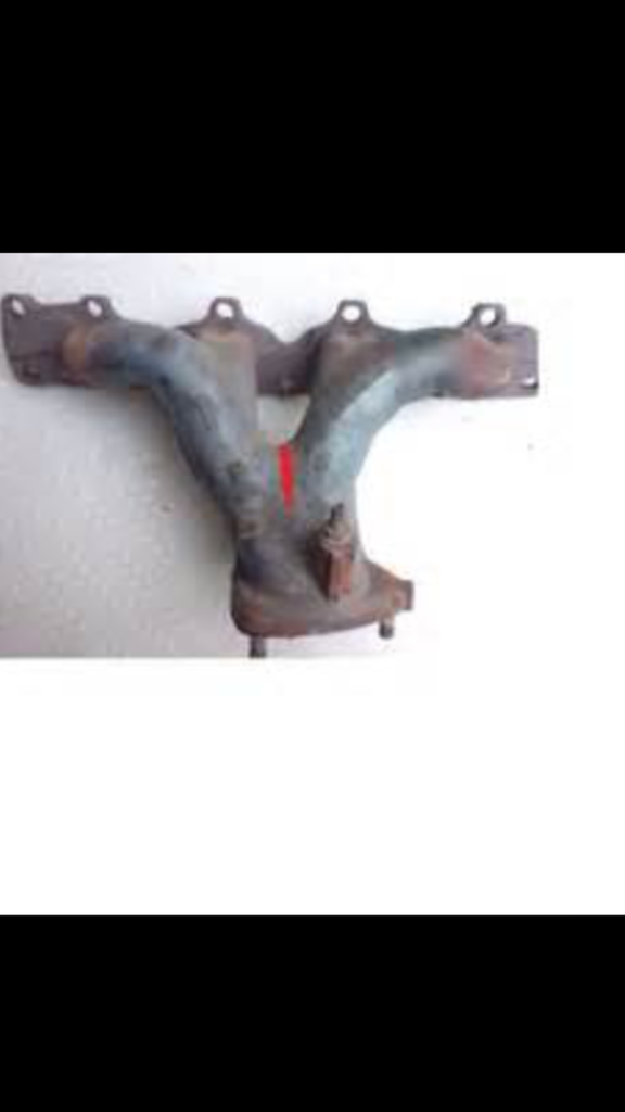

#5 The Batman
Posted 10 November 2015 - 12:24 AM
That's not a crack When was the timing chain last done?
Edited by The Batman, 10 November 2015 - 12:25 AM.
#6 GaryK
GaryK
  • 168 posts
  • Location:Bury St. Edmunds
Posted 10 November 2015 - 12:32 AM
Ah, OK... Couldn't see anything else, even hairline, but can't see much by just pulling the heat shield back. Chains were done by Vocky in June 2010, just over 10k ago.
#7 The Batman
Posted 10 November 2015 - 01:08 AM
Look in the middle of 2 and 3 exhaust primaries that's usually where it cracks
Like this:
