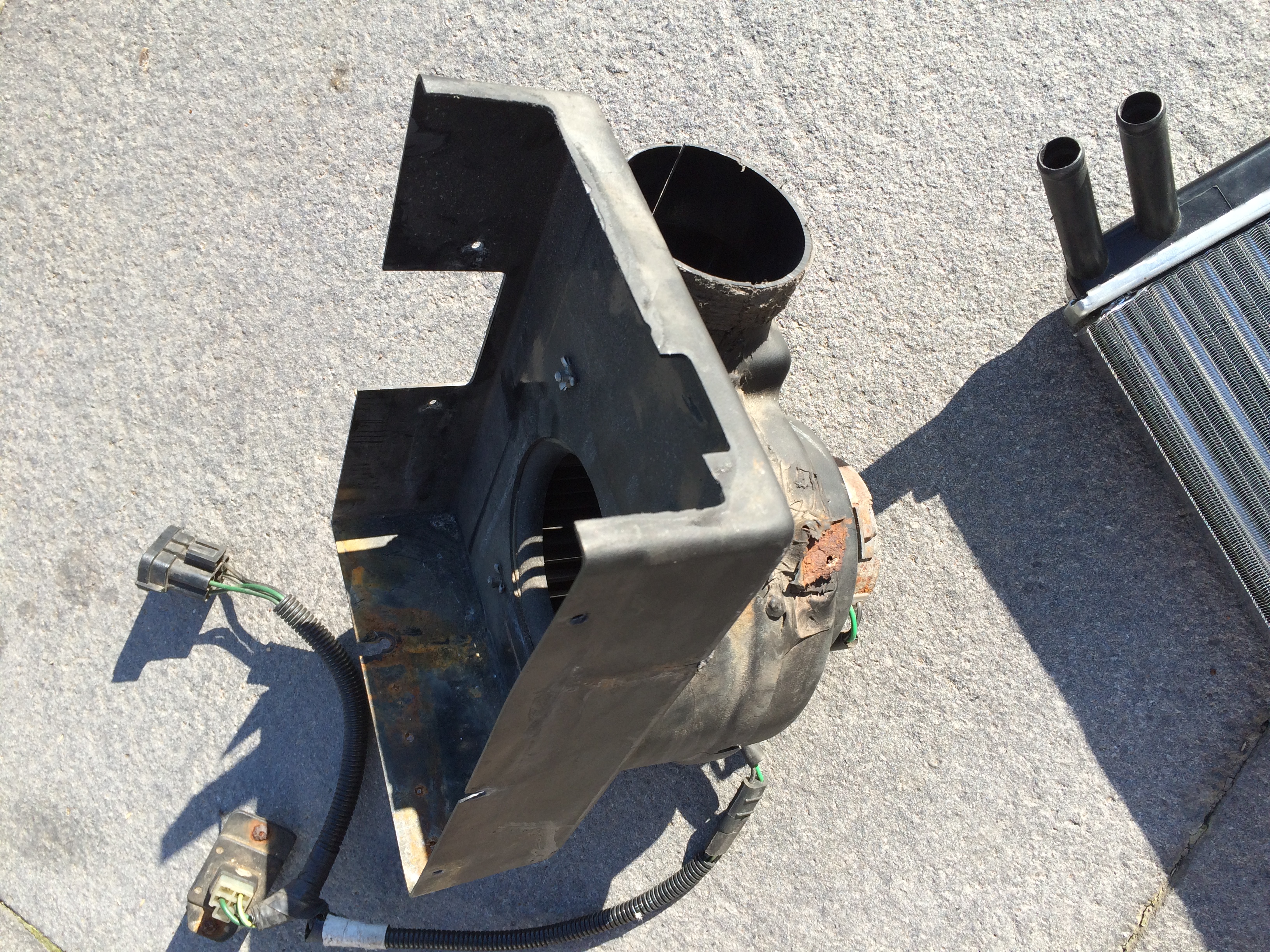

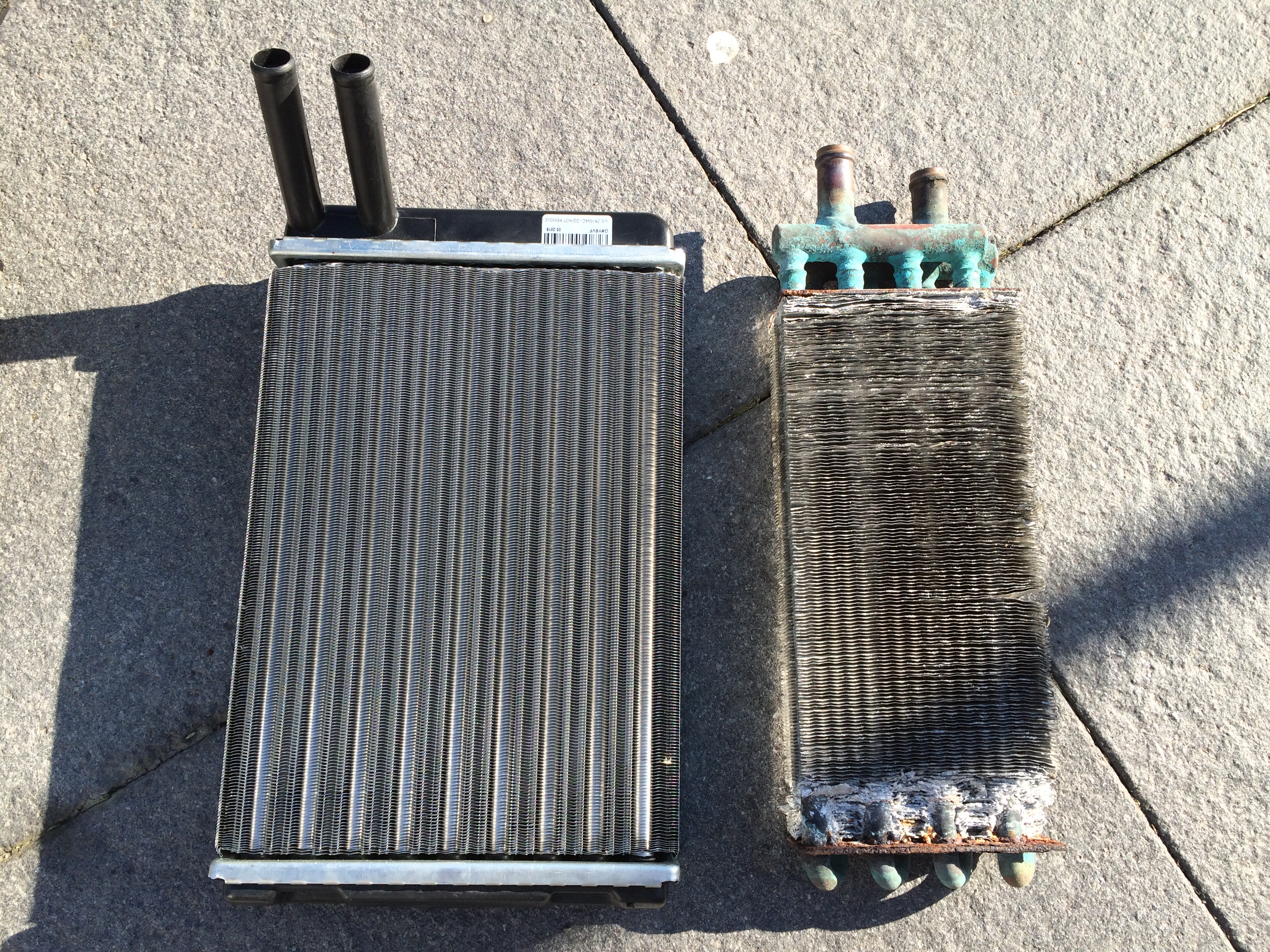

edit, in other news, my €25 Volvo heater core just turned up... fits like a glove, and is double the size of the old core. not a mod for everyone, as the pipe orientation suits my bodgy RHD-LHD conversion, but for me is a perfect solution. ditched the flap, ditched the stock intake hole. the whole box is now filled with core, and ill use a bypass valve to regulate the temp.
pics to come

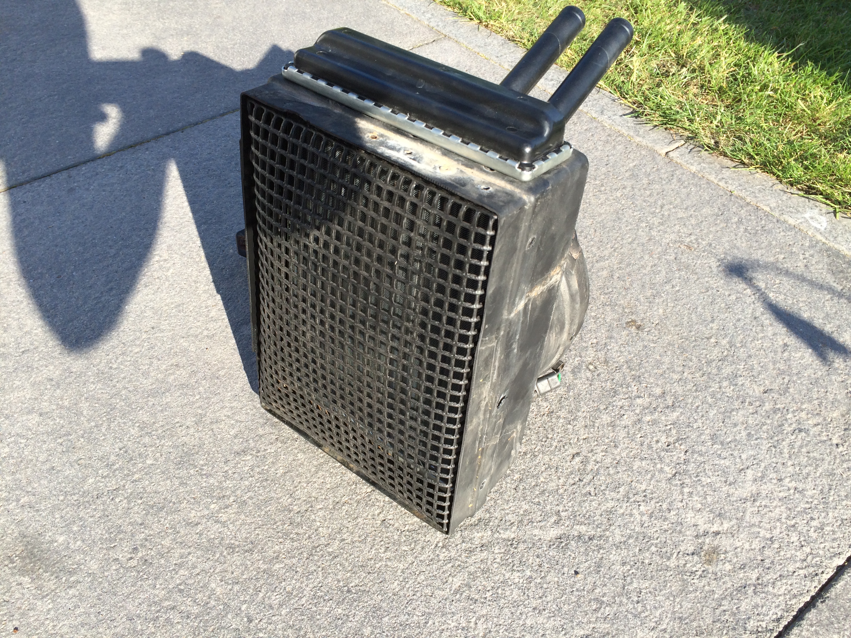

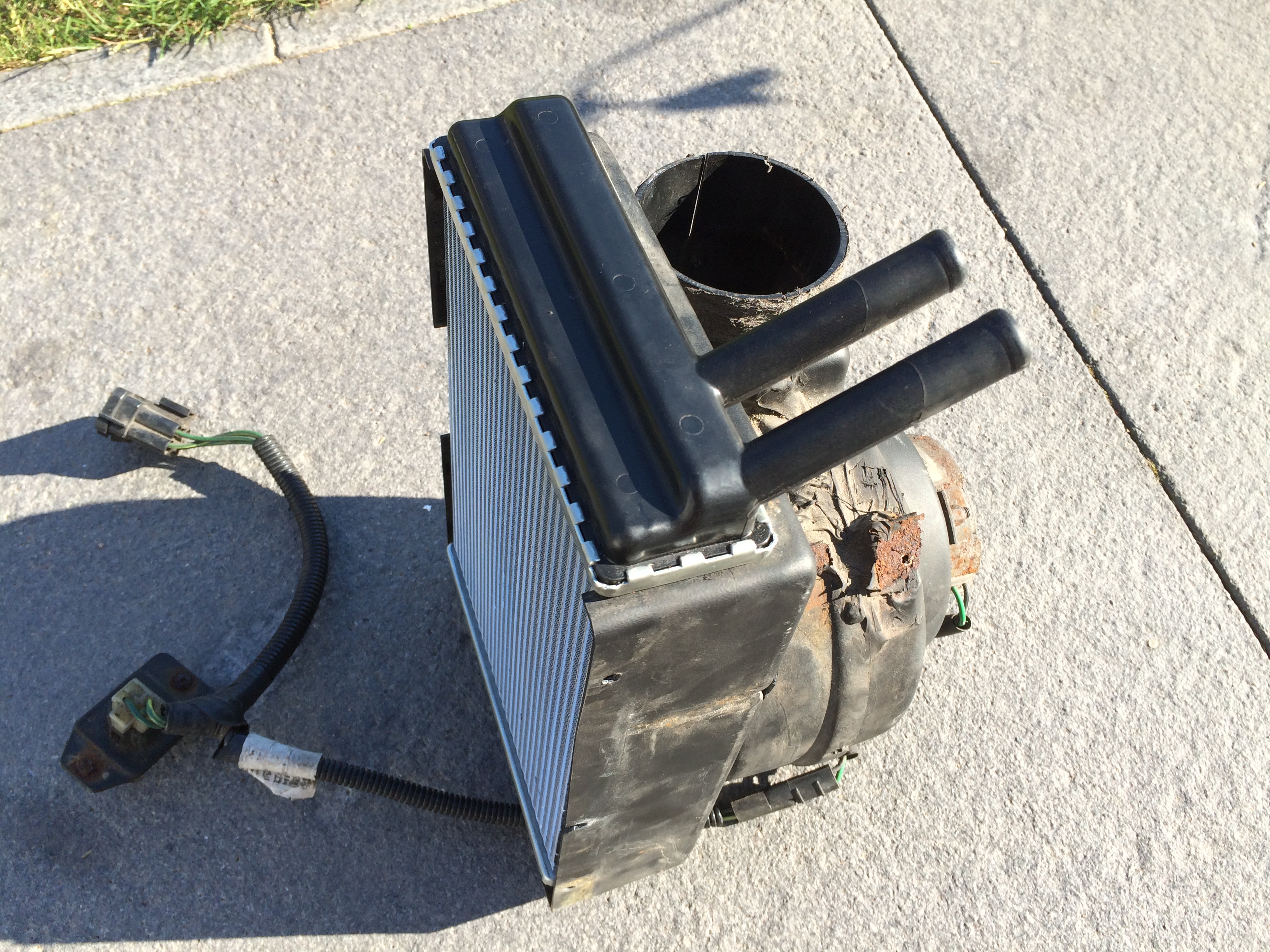

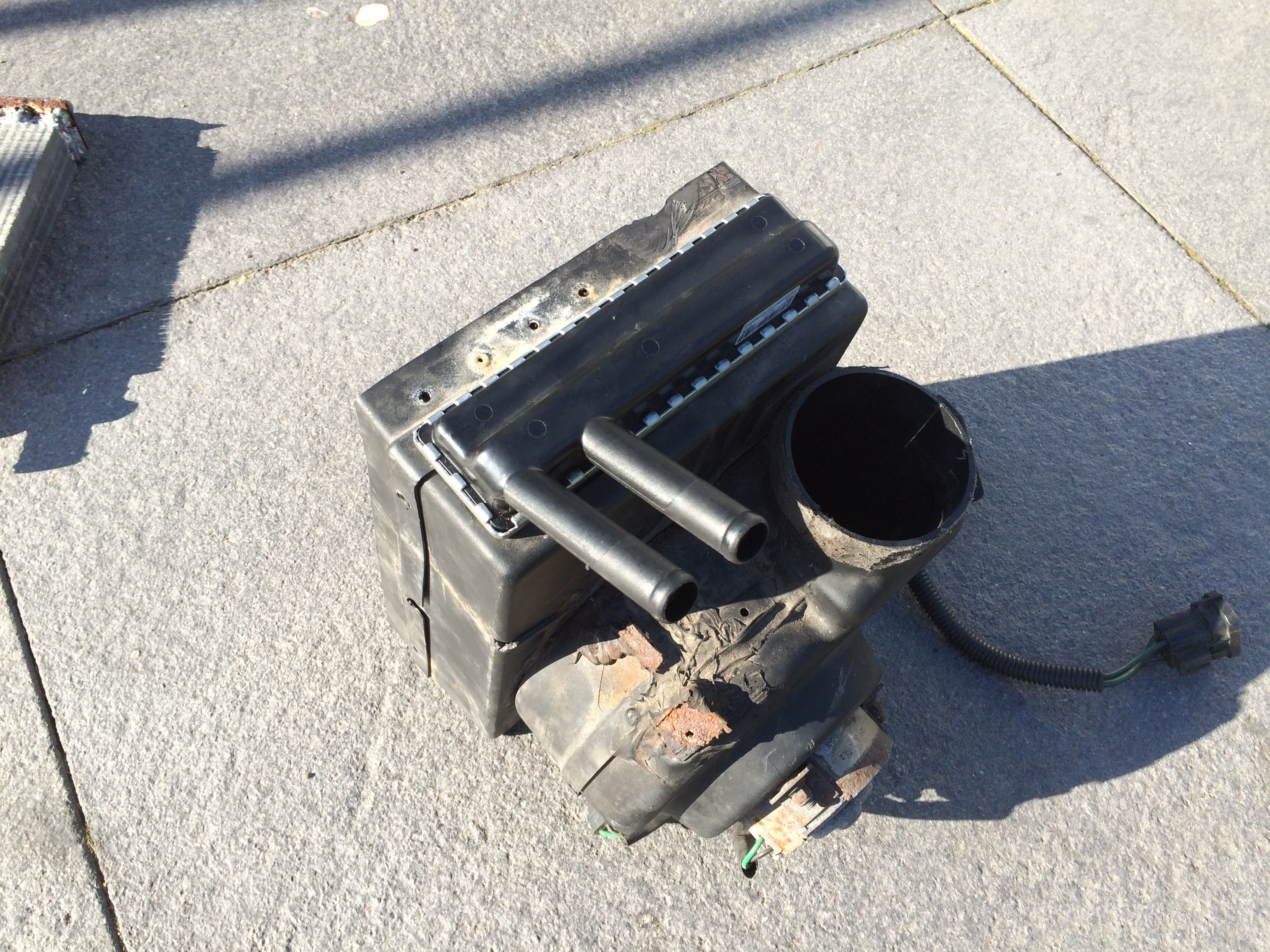

#269 Doctor Ed
Posted 12 May 2016 - 06:33 PM
Volvo 940 core stuffed into the OEM heater box
the core completely fills the box, and the top tank sits conveniently atop everything allowing good access to the hoses.
pics are rather self explanatory, but any q's just ask :)

#272 Doctor Ed
Posted 13 May 2016 - 01:03 PM
Will it fit rotated 90 degrees horizontal? Looks close.
very close if you remove the 2cm piece with the grill, but even then its still about 5-10mm too big. plus half the core's intake would be blocked by the front bulkhead. the fully exposed side facing intake has a nice source of air from the front (hopefully not too dirty) and the alignment of the fan outlet/ducting inlet are pretty well lined up (when using a RHD heater box in LHD location anyway!) ive got a pic ill upload in a sec

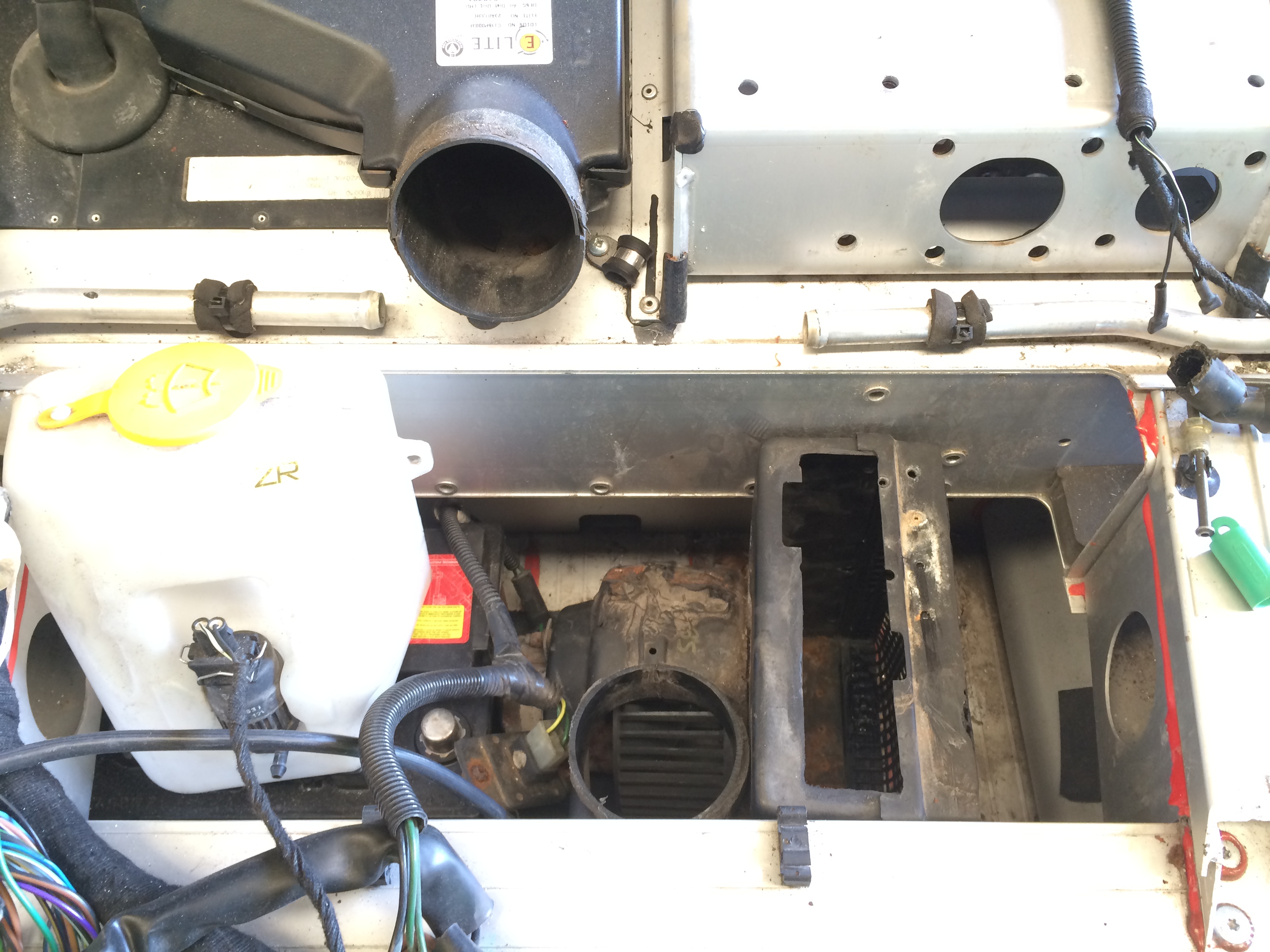

Ed has fitted the intake to the side of the old heater box as the side of the new matrix blocks the standard input completely. So as he mentions above rotated 90 degrees the air will flow directly through the matrix and into the fan rather than the convoluted method the OEM one takes.
